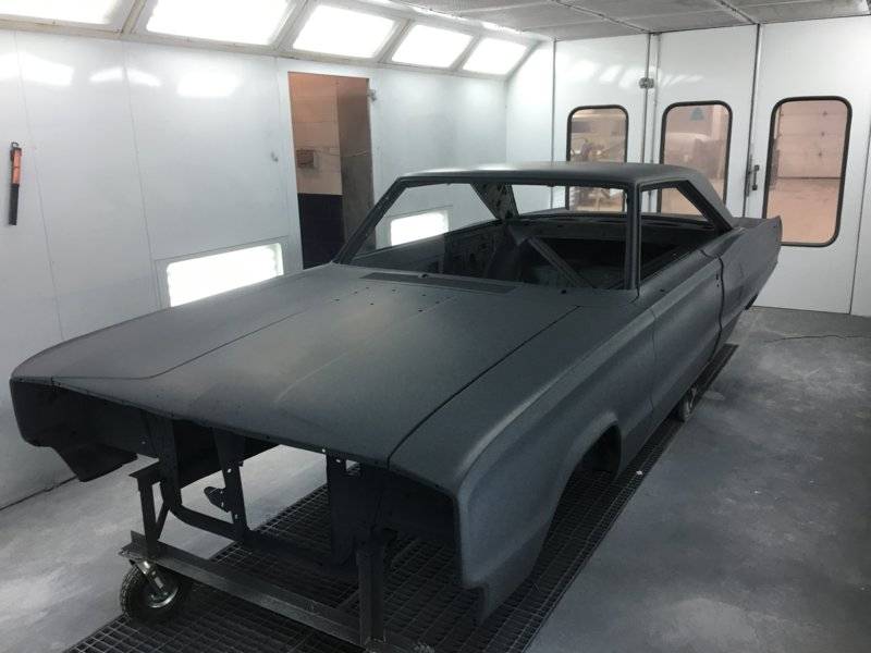

Thanks for the info. My friend who is painting my car has a fairly big spray booth so I'm sure he will be able to open the doors, hood, and trunk when he paints it all at once. He will start off by spraying everything with an epoxy primer and then probably do the darker gray dip tank primer over that and then body color.
