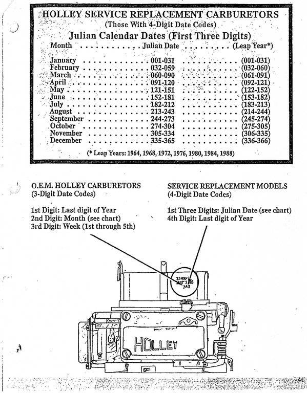

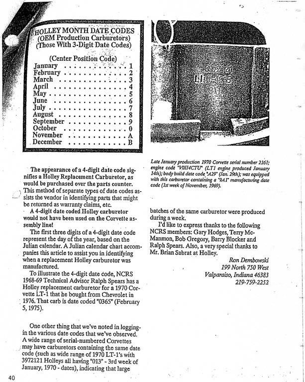

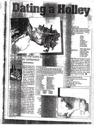

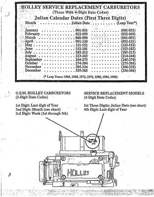

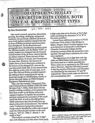

O.K. here we go, I just got a old doc from Holley Tech Dept. It has been scanned a few times and the first page is hard to read but the rest is clear enough.
Holley Date Code 1.jpg Holley Date Code 2.jpg Holley Date Code 3.jpg Holley Date Code 4.jpg
Also Ty from Holley told me that all production line carbs have a factory part # and replacements do not, but I know that in the last 5 years Holley has put the factory # back on Mopar new replacement carbs sold by Mopar

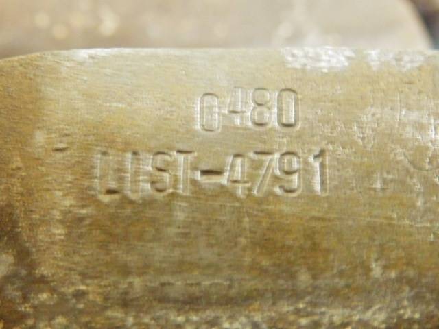

Well,here is an original assembly line 4391 center from a T/A,you decide.
