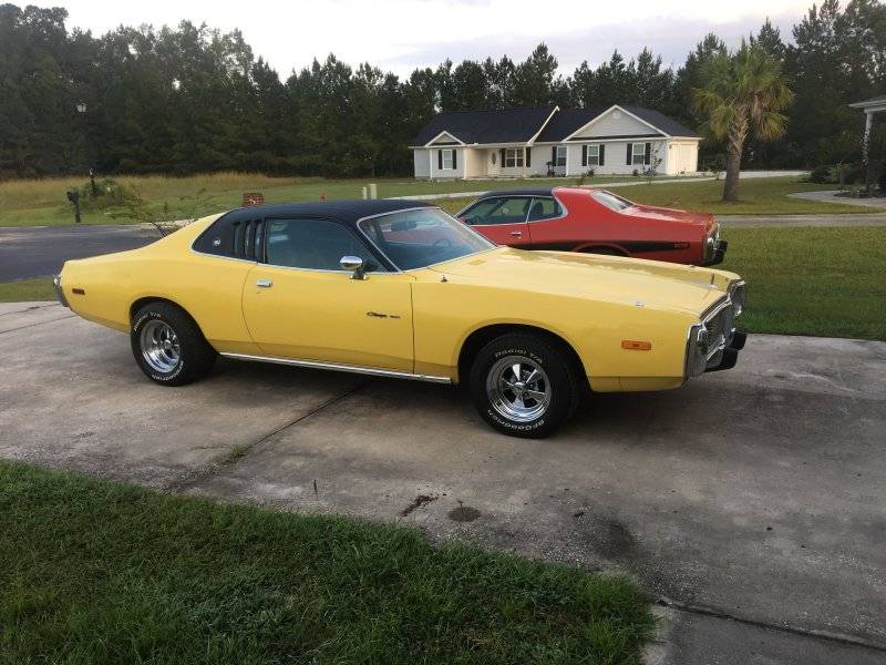

73 Charger SE P code with a towing package out of California. Original paint. The red one behind it is a 74 U code like my current 74.

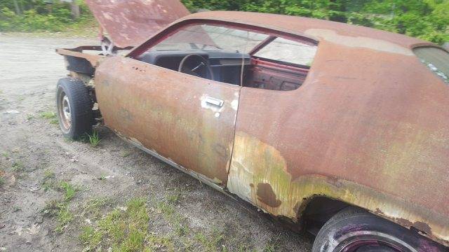

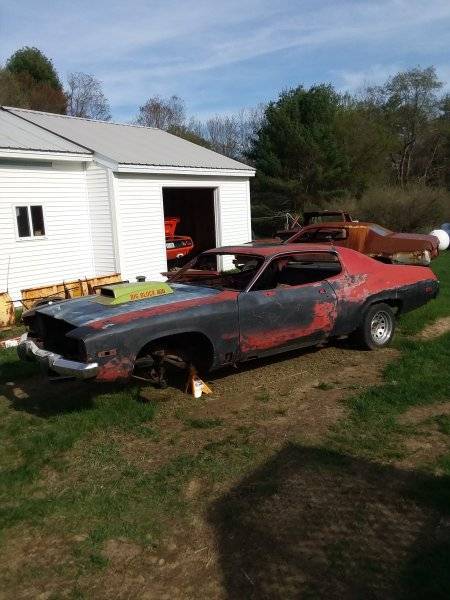

I had two P code `73 road runners, one I parted out and the other one was a red on black four speed car I sold last year as a major resto project as I just wasn`t going to get to it.

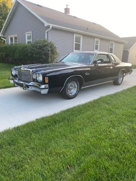

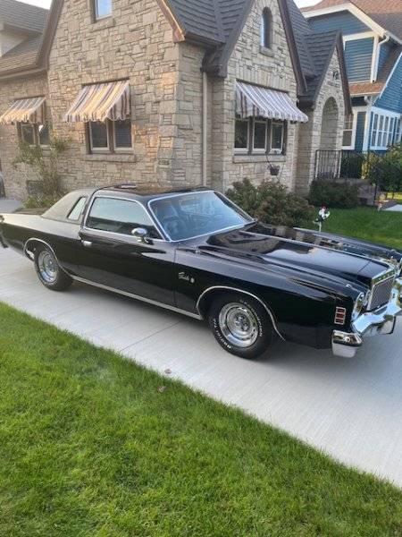

I recently purchased this 1976 Chrysler Cordoba from California, as the owner passed away in 2024. The towing company was contacted and had a lien on the vehicle for their services and storage. A man purchased it, and that is who I purchased it from. It has the ultra-rare "P" code 400. I did send a letter to the deceased owner's son to see if he has more history of the car.
