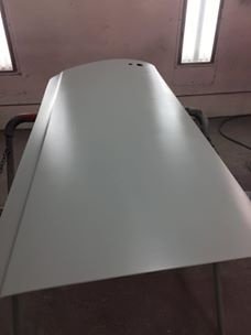

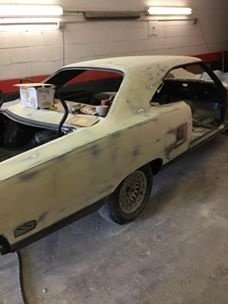

Hey guys,
As you can see in the photo's I have my 70 RR in the shop getting ready for paint and I have a few questions. Hope you guys can answer me. since my car isn't an all #'s matching car I am making her the way I would have ordered her from the dealer. So with that being said I am going with Vitamin C outside with an black interior. So my question is how much the original cars where painted body color and what was painted black for the interior, was it just the insides of the front doors, because the door panels didn't go all the way to the top of the doors? Question number 2 I am trying to determine the status of the chrome stuff I have can it be re-chromed or is there good quality chrome out there? I have the 2 vent windows and a bumper that is pretty beat-up I need to find the front and rear window trim. Can anyone help pictures are Great also!

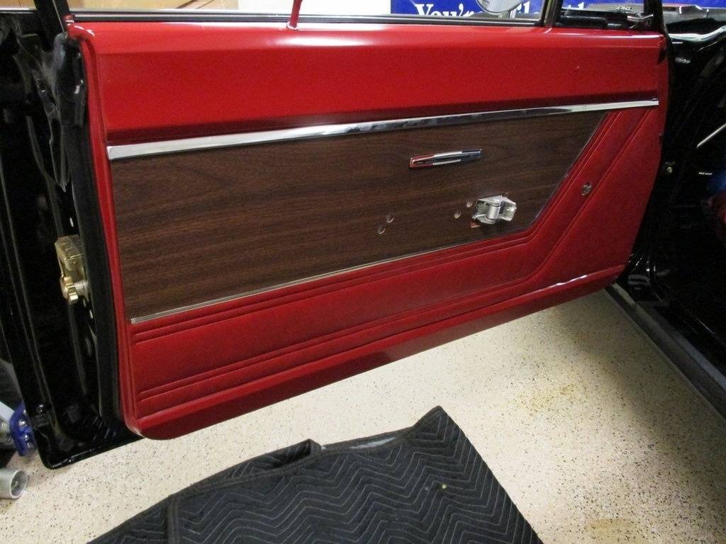

Plymouths the inner perimeter of the door was painted from where the door weatherstrip is attached if different from exterior body color. For example a black car with red interior the inner portion is red. So you would have vitamin C exterior and up to the midline of the clip area and black from the clip area to the inside....
Here is a pic from my GTX I am working on....
So the whole area that is red is paint?
On the door it is red up to the door seal. The rest of the door is body color inside and outside it is split at the seal around the inner perimeter.
The rear upper removable metal door pads are painted the interior color....The upper metal roof rail frame is painted interior color...
Here is my build thread start about midway forward....This is an original black exterior and red interior being restored correctly....
