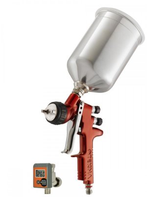

The Tekna is a Devilbiss FYI.. ( priced in between) using the dekups systems with as well... lot easier than all that cleaning !
I own a Tekna copper and love it!It takes a little getting used to and tuning.It sprays metallics awsome,fan pattern of almost sixteen inches.I was always partial to Sata for many years,but almost converted to all Tekna now.I will stepping up to the new tekna black,wich is waterborne ready.
Forgot to mention the D-cups are the only way to go.Even for the DIY/weekend warrior.Less clean up and less cleaning chemicals.

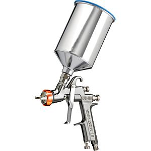

I use Iwata spray guns now. Their pretty spendy, but I do it for a living. I used to use SATA's but I switched a few years ago.
Devilbiss has some good guns out there, but I haven't used them in years.
My Iwata's I spray with are LPH 400's
