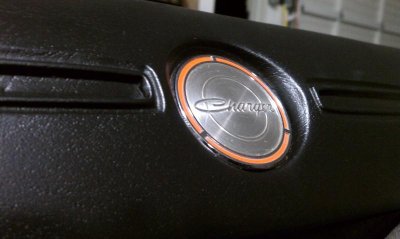

Colorcoat works absolutely awesome, is tough as hell, and actually dries in the finish you want. Just did some plastic interior pieces and vinyl door pads for my Charger last weekend, I'll post some pics later today.

Not the greatest pictures but here's some of the stuff I used it on.
