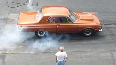

I painted the outside, the engine compartment, inside of the trunk, underside of the front stub, insides of the front fenders. I did not paint the floor pan top or bottom body color. We used 2.5 gallons of Dupont over a light grey sealer. I have a little over a quart left that matches just in case.
