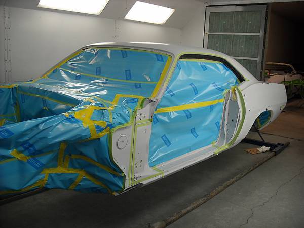

If you are spraying BC/CC non-metallic you should be fine to paint the car while blown apart. People forget that a first time painter usually is a lot slower and that makes it very hard to keep a wet edge when spraying the car whole. Just remember to mask it very well (like the pic below, not my booth). Buy all your paint at one time and mix cans if you have more than one. A gallon of paint with 1:1 will give you two gallons of paint to spray. Adjust your gun and then leave it alone or remember the settings you used if you can't spray all the pieces parts in one day. Keep your spray mechanics the same (overlap, speed, etc) and remember to run off the panel edge so you don't get buildup on the edge. Paint from roof to rocker so you don't drag your hose on your fresh paint. I don't have a lot of room where I spray so I do the doors, hood, trunk. and other small pieces in one batch and then do the main body later. I break the rules and spray the hood and trunk vertical instead of flat (less dust gets in the paint that way) and I have not had any color match problems. I use two coats base and two coats clear. I spray the doors on edge as if they were on the car. If for some reason you really mess something up, STOP, let it dry, sand it out, and start again. Would highly recommend that your spray on a seal coat so that everything after that has even color to land on. This will also let you practice your new found skill since mistakes in a seal coat are super east to fix. There are ton of other things involved but the main thing I have found is dust, dust, dust. Wipe it down, then wipe it down again, then tack and tack again. Good luck and have some fun.
