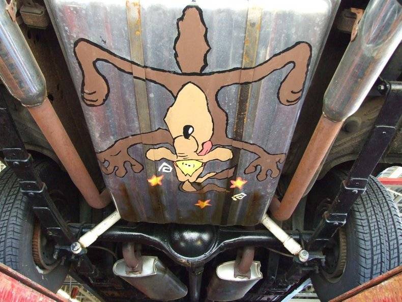

hear do this

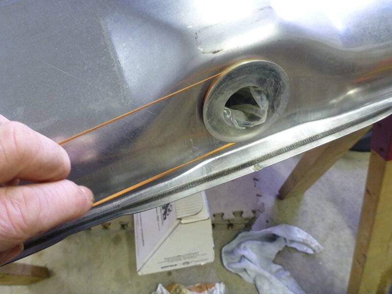

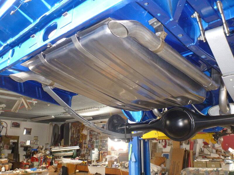

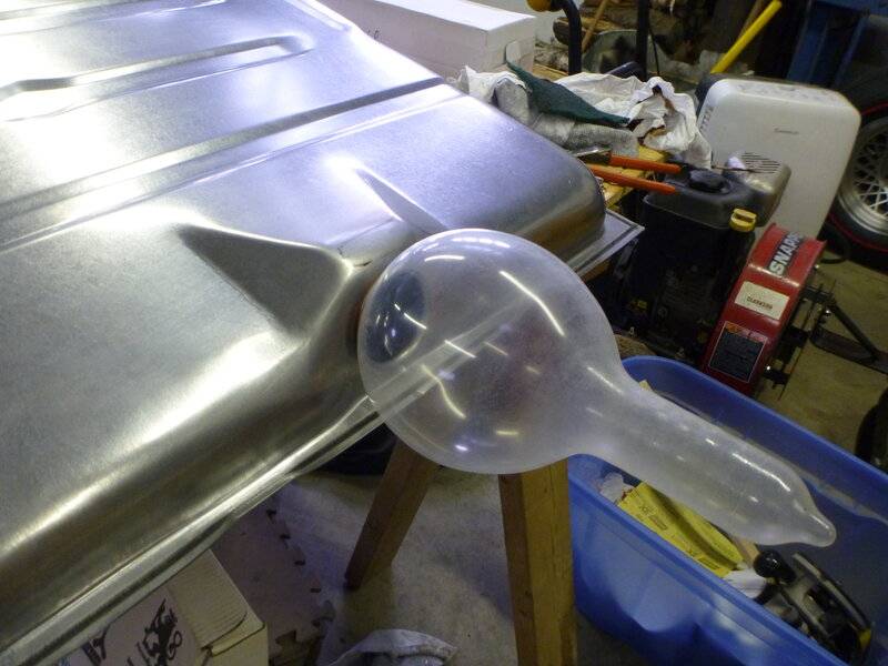

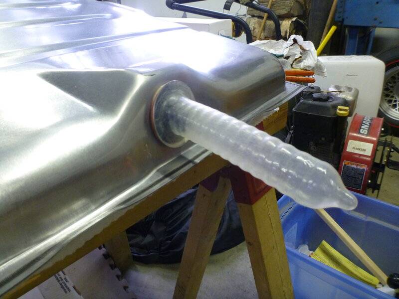

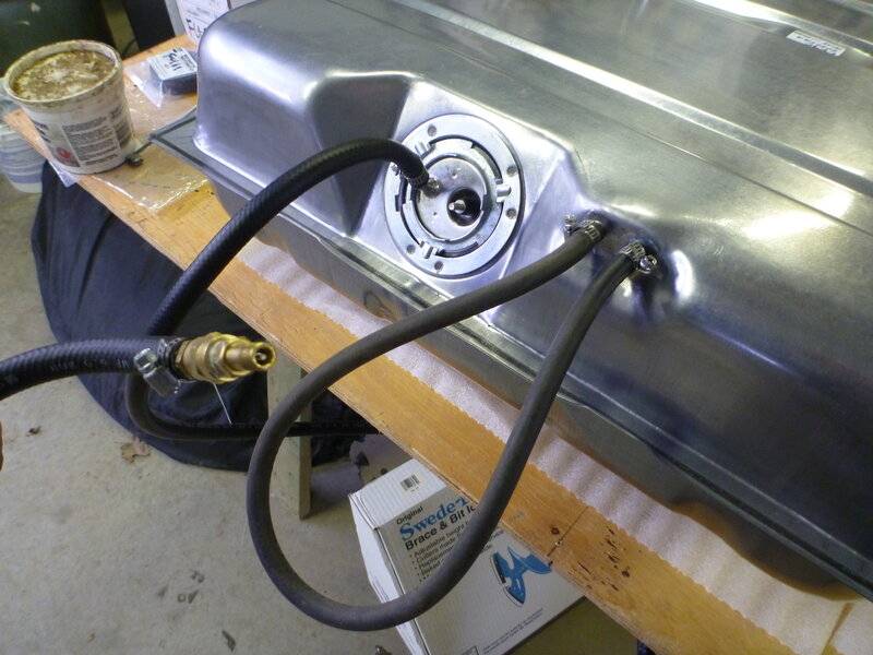

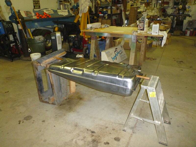

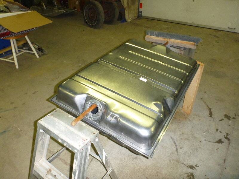

Clear coated mine...
Did you have issues with any of the internal vent lines in the tank? I had my new Spectra tank powdercoated and the soldered-on vent line connections inside the tank melted. Solder melts at less temperature than the powdercoat baking temp.

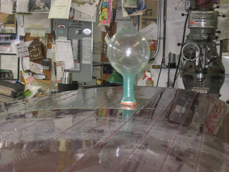

No issues wiping all the mfg oils off with reducer and clearing it. Sounds like your powerercoater just wanted your money, as they certainly should know their temps. And as an airplane builder I always pressure test tanks so there are no surprises...

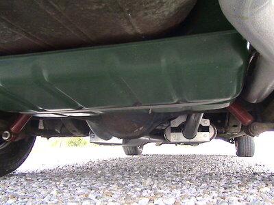

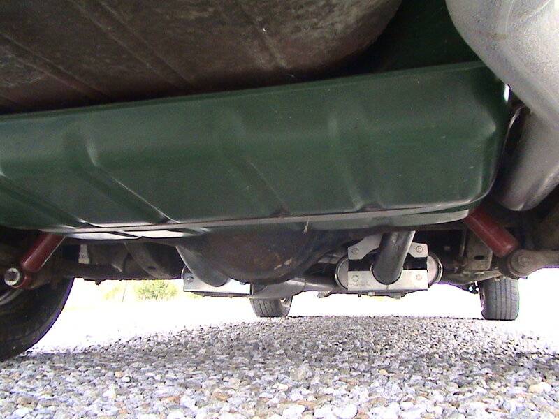

I found some green paint laying around the garage and used it up on my new tank replacement and after ten years it still looks OK (it took some doing cleaning the oily film the repro gas tank was covered with when I opened the box). Not factory appearing at all, but unique (kinda nerdy like me).
