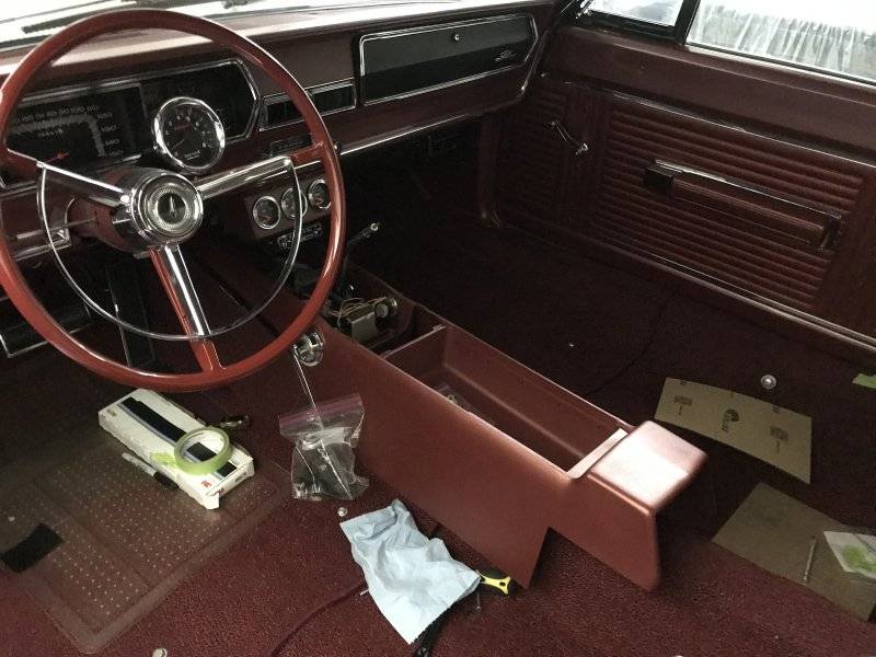

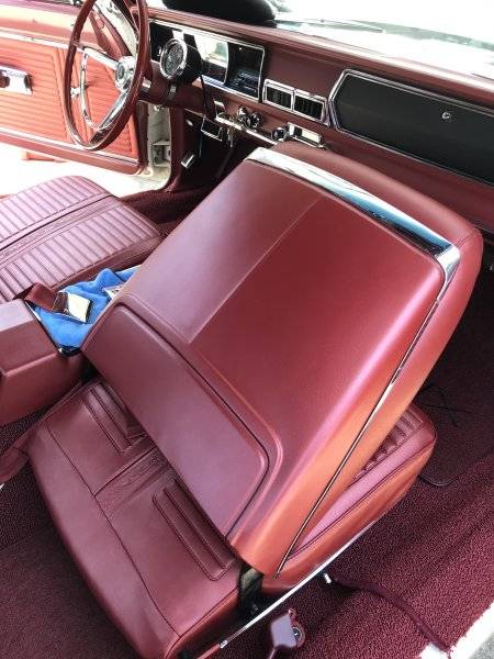

I used Herbs on my '71 Cuda without any problems, although the color I chose was white. Different textures can reflect light differently, but as long as the finish is consistent throughout the car, I don't think anyone would notice. So I would stay away from a clear coat, in my opinion. Mind sharing a few pictures?
I clear coated my white vinyl & white metal interior paint.

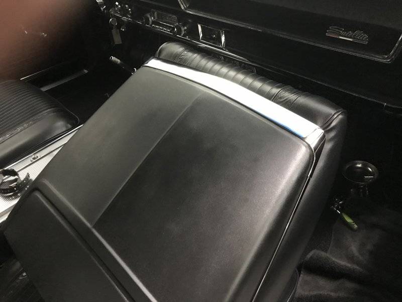

The hinge covers (metal) look fine to me, but the plastic feels less glossy. For reference, the buddy seat bracket covers are painted on the outside (bottom one) and not repainted on top one

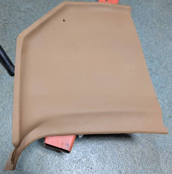

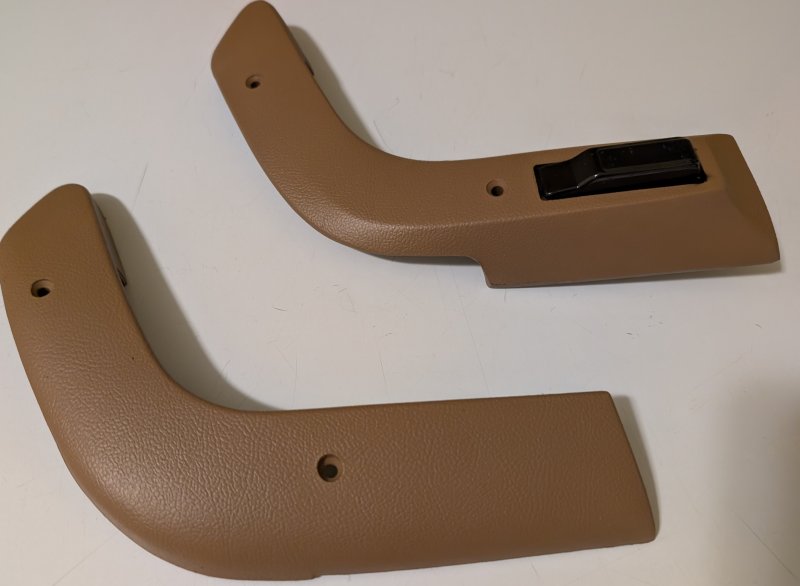

Here are a few photos of parts with SEM Satin over them.
Here are some pieces I coated with low luster clear a few years ago. I thought they were a little flat but may be just right in the view of others.
