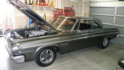

The light in the garage doesn't do any justice, but the rims match the car color damn near perfect and I bought the rims before I got the car painted. I get asked alot if I had the rims done to match and I tell them no, so go for it, you will like it!!
