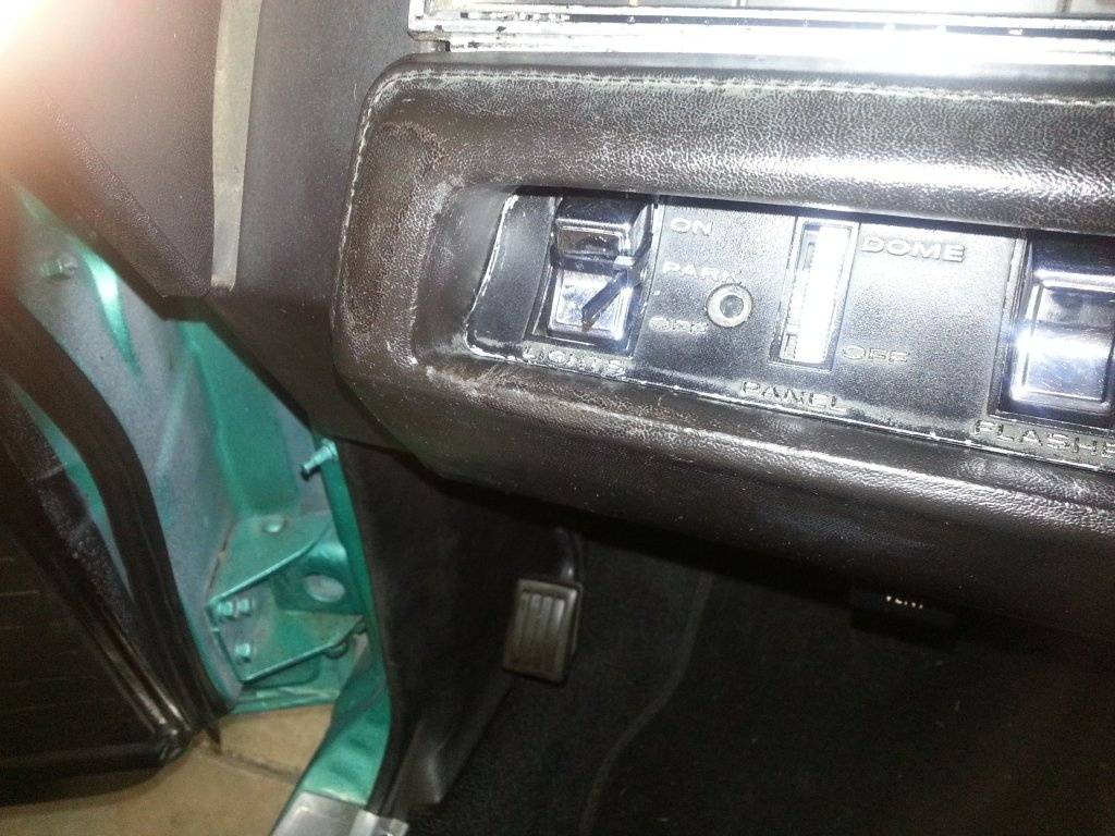

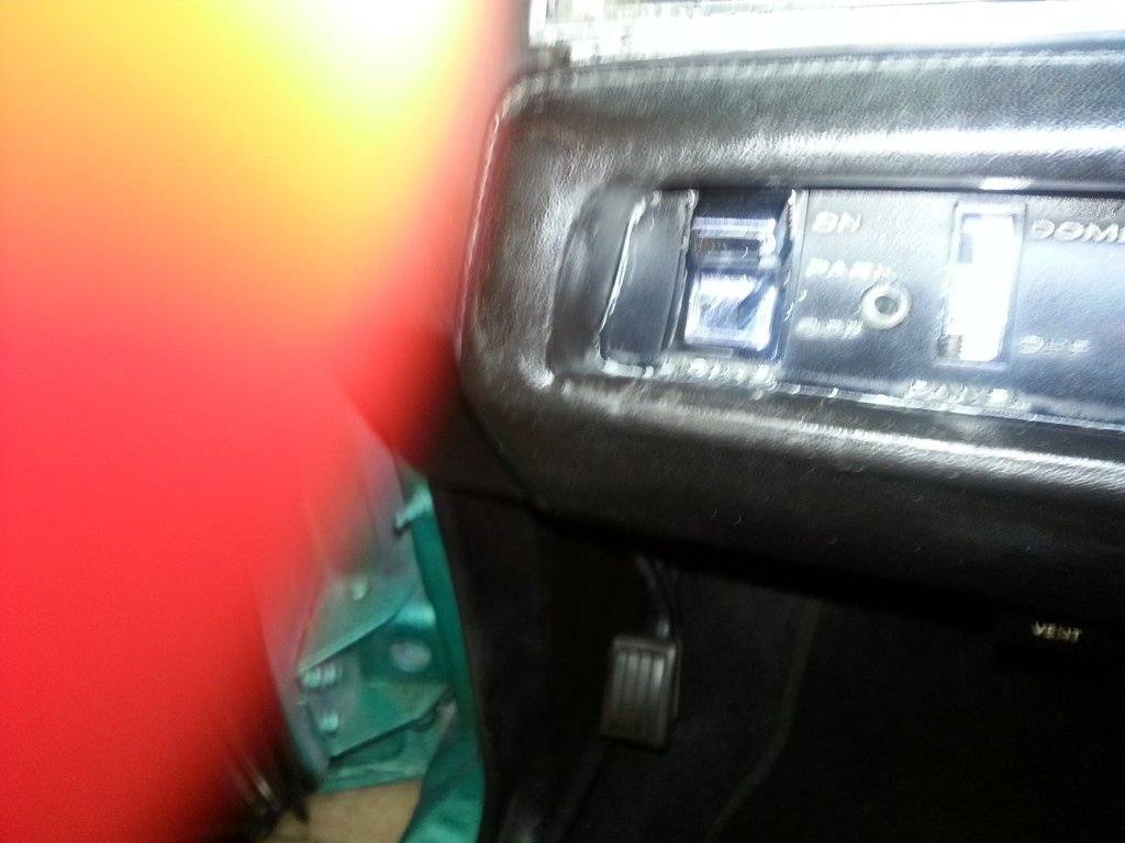

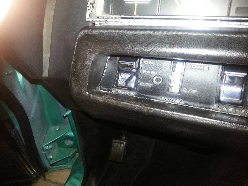

Well, the switch pod is back in the dash. B Body expert JimKueneman was correct in that the switch pod will not, and cannot go back into the dash with the dimmer installed. One item that Jim did not run into that I did was this is also true (in my case) for the headlight switch. This switch pod would not go into the dash (nor would it come out) unless the headlight switch was removed.
After frustrations trying to install the headlight switch from under the dash, I got Roadkill creative. Took the smallest ZipTie I had and wrapped it tight across the rocker. This wedged the switch perfectly in alignment with the screw mount holes. A 8 inch self magnetized Philips screwdriver and I was done! Cut the ZipTie on one side and using a dental tool fished it out of the switch. Sounds RoadKill stupid, but it worked. See pictures.
