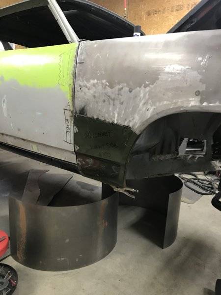

I’ve seen some of you guys post pictures of welded patches and spliced panels where you can’t even tell any work was done. Lots of examples in Pat’s Bullet Charger build thread. My question is do you grind each set of spot welds before making the next series of welds? I have a gap so the panels don’t but and warp but I’m wanting some suggestions to improve my rather mediocre metal skills.

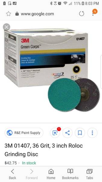

I use these and generally knock the majority of the weld down as I go then finish them off once done. I see you using TIG a lot, TIG welds are softer and much friendlier to hammer and dolly work which can be helpful. Given your skills I have no doubt you'll knock it out.

I have those in 2” and 3” that I use in the air grinder.

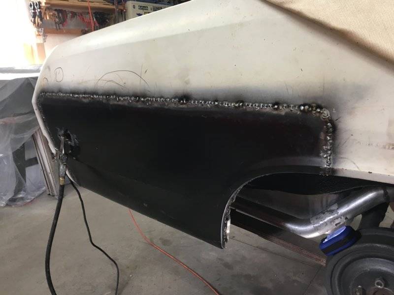

I cut a 1/16” gap in this panel and I’m using the mig since it’s a horizontal joint and I need to improve my MIG welding game on sheet metal. If it was a vertical joint, I’d have a much tighter fit up, run a vertical down with the TIG and knock it out.
Weld in random spots. Cool down. Weld again. Cool. Repeat process till seam is welded. Grind with 36 on small 2" rolock till weld is close to flush. Watch the heat build from grinding. Cool when it starts to get warm. Grind flush with 80 on larger 3" rolock or disc till flush. Cool as grinding. DA with 180 grit. Try to keep the discs as flat as possible on the surface. Dont use flapper wheels on a 4 1/2" disc grinder. They induce too much heat. I have seen them used with good results but it takes a light touch.

Ok guys, I tried the cut off wheel trick and I have to say it’s not for me. I started practicing by patching the antenna hole. Not bad, went slow and found the compressed air nozzle worked the best for keeping heat out. Another thing I learned is to clip the wire before each pull of the trigger no matter how much of a pain it was. That gave me clean, consistent welds each time. Here’s the antenna hole after I shot it with self etch from a rattle can.

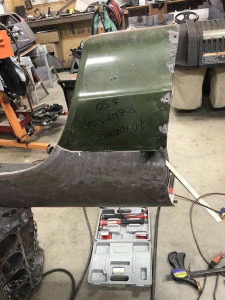

I went on to do the lower fender patch. That went ok. I knocked it all down with 36grit on a 3” roloc and then 80 in the DA. The area above the seam is going to need a skimcoat of filler, but I knew that going in. These fenders probably weren’t worth salvaging.

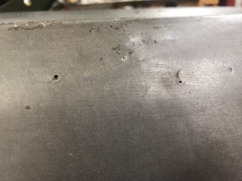

I don’t hate it and I know the next one will probably look better. Now, for the next question... how do I fix these thin areas where it blew holes when blasted?

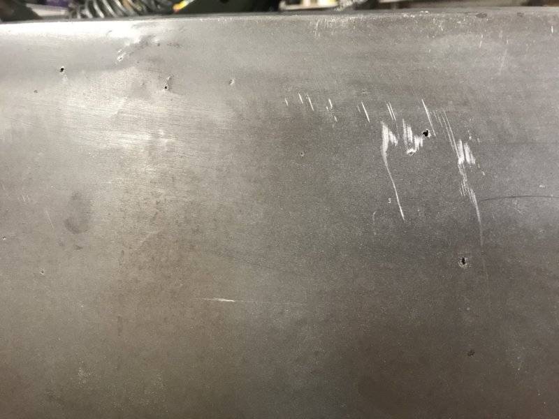

You can see this thin area ‘blistered’ from the abrasive it was so thin. Should I cut out and weld in a patch?
I hate to say it but that looks pretty thin to me. Have you priced a new AMD fender?

It’s a 70 coronet fender on a Superbird clone. AMD doesn’t make them and mint originals fetch $1500 each... unfortunately, I have to make chicken salad out of chicken ****.
