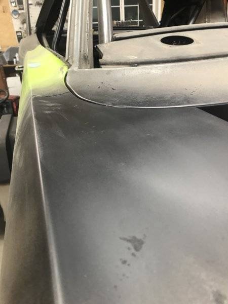

Ok guys, I tried the cut off wheel trick and I have to say it’s not for me. I started practicing by patching the antenna hole. Not bad, went slow and found the compressed air nozzle worked the best for keeping heat out. Another thing I learned is to clip the wire before each pull of the trigger no matter how much of a pain it was. That gave me clean, consistent welds each time. Here’s the antenna hole after I shot it with self etch from a rattle can.

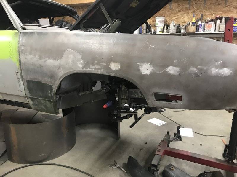

I went on to do the lower fender patch. That went ok. I knocked it all down with 36grit on a 3” roloc and then 80 in the DA. The area above the seam is going to need a skimcoat of filler, but I knew that going in. These fenders probably weren’t worth salvaging.

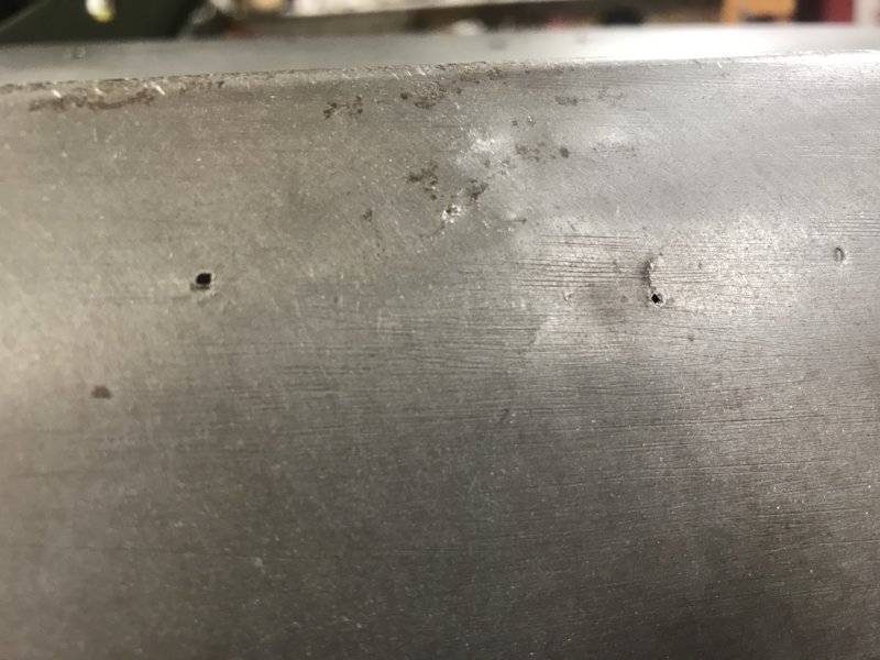

I don’t hate it and I know the next one will probably look better. Now, for the next question... how do I fix these thin areas where it blew holes when blasted?

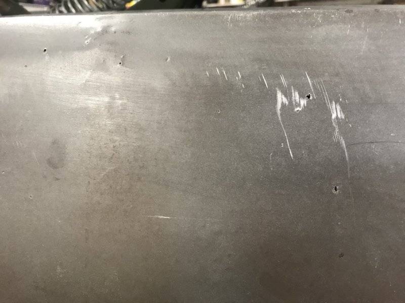

You can see this thin area ‘blistered’ from the abrasive it was so thin. Should I cut out and weld in a patch?
That depends on the backside, I've looked inside only to find a small rust pit on an otherwise clean panel, If that's the case I just weld it shut. If it's rursted thin in areas to large to weld shut I start patching in new metal.

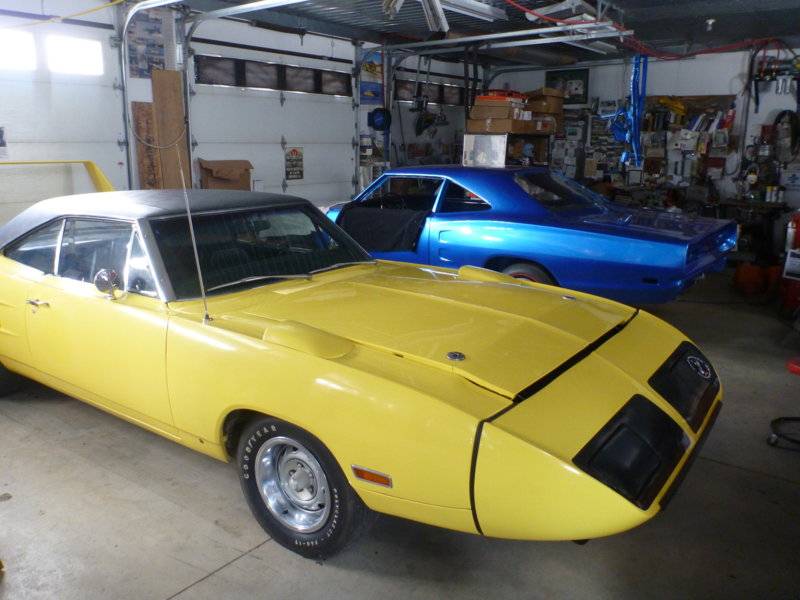

Just so I can get brain around this, Superbird clone from what base car?
The gurus on here can correct me but wouldn't a fender from a 70 Roadrunner work?

The Superbird was a Plymouth Road Runner with modified Dodge Coronet/Super Bee fenders. They’re needed to mate with this...
No, I understand that but the Superbird was basically a modified 70 Roadrunner. The Dodge Daytona was a bit different beast.
The gods on here can correct me but I would doubt that that the Daytona nose cone would mate properly with the Superbird fenders.
Daytona is essentially a Charger. Superbird is a Roadrunner.
Dodge vs Plymouth.
He already did correct you. The front fenders on a Superbird are from a '70 Dodge Coronet to mate the nose cone.

Just so I understand correctly, Ma Mopar used the Dodge Coronet fender on the Plymouth Superbird to get the nose cone to fit? Or is it an anomaly from the clone you're working on?
Not trying to be a dick here I just need to know as it's an interesting bit of history.

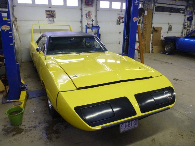

Yes MA Mopar let them run across town to the Dodge factory and stole some fenders for the Plymouths to turn a Roadrunner into a Superbird. Mine is real...
You can try to give it the old copper spoon.
Drill out each blow out with next size drill bit larger than the hole. Then fill it. You can pick up a copper back up plate from harbor freight very reasonable. Then grind flat with 36 grit roloc.
