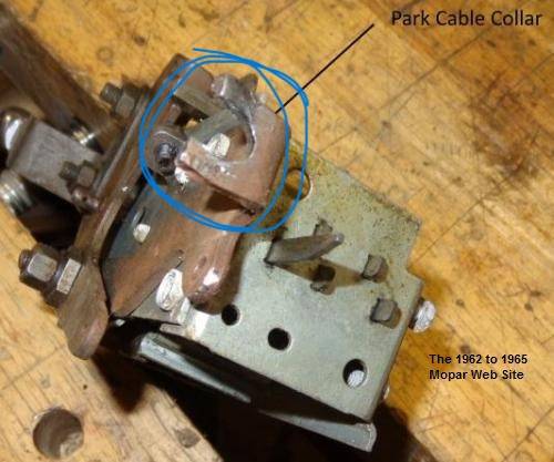

Talking about the shifter end behind the dashboard (not transmission end) of the "Park" cable on a push button transmission shifter, not a parking brake cable.
The cable sheath is attached to the push button shifter assembly by "crimping" the metal of the shifter housing around a groove in the cable housing.

Can you post a picture of it?
Is this the crimp you are looking at? If so, you need to spread the tabs with a snap ring type tool to get the cable out.
Or a couple sets of pliers to pull it apart. If the tabs bend much you can straighten them in a vise.
Kinda hard getting 2 pliers and 2 hands behind the dash behind the shifter though. If there was a "snap ring plier" type tool that could expand it it would be easy.
Unbolt the shifter from the dash first.
