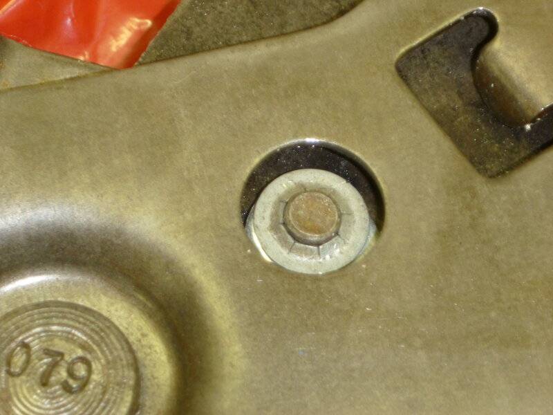

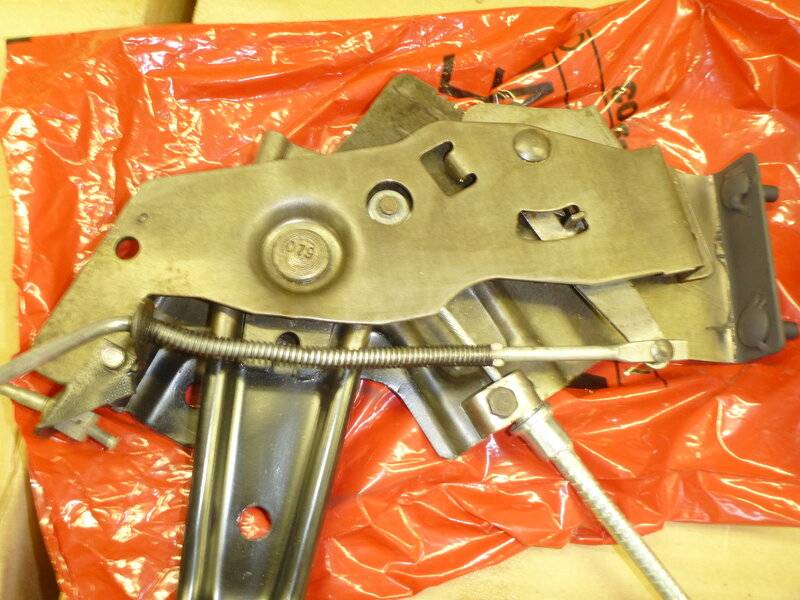

I just got new cables for my 70 Road Runner. Someone else took this apart a long time ago so... how does the cable connect to the pedal assembly? Bolt? Pin? ?? Pictures would be awesome!

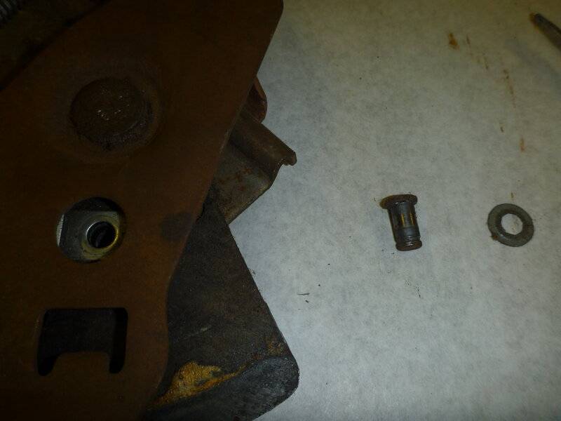

Just put a WTB in the classifieds, someone will have one. No room for a bolt and nut..
How did you remove that clip that hold the pin?
Kevin
Don't remember what I did yesterday, let alone 6 years ago, but probably a simple wiggle and pry with a flat screwdriver, working my way around the push nut, or I may have used a punch and smacked the pin..
