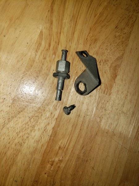

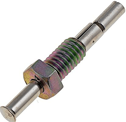

Hear is one that you could make work it has the 5/16 thread like the original parking brake switch the door switches are 3/8 threads you will have to make a spacer as the hex is not as long as the oem as you can see the longer hex is an original switch. This is available threw jegs #11121 otherwise i suggests you look at a salvage yard that is were I found the one pictured felt like winning the lottery when I found it.
