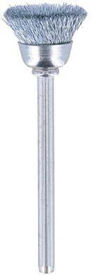

When you finally get the bulb out, get a Dremel wire brush bit. It fits perfectly inside the socket. It will remove years of built up crud. You don't need an actual Dremel tool, a regular drill will work just fine.
