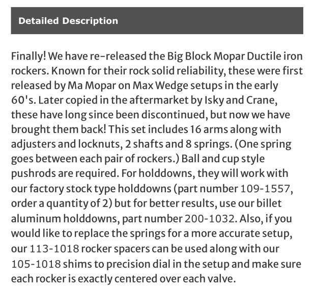

Do you have any suggestions on the rockers? I believe that since what I have is so old that it would be best to purchase and entire kit.
I haven't built anything with stock rocker arms, and under 0.500" lift valve lift in the last 20 years. On my old 360 engine I ran the Crane Gold 1.6:1 rocker arms, and most of the stroker engines (over 0.600"+ lift) have used the Harlan Sharpe rockers that used to be more mid priced, but have gotten pretty expensive. The Charger (over 0.700"+ lift) is using the T@D rocker arms that are also expensive.
I'm sure someone will post what they are using on a milder setup?
Maybe the 440 source rocker arms? Price seems really good?
