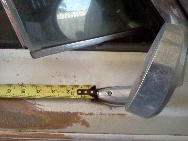

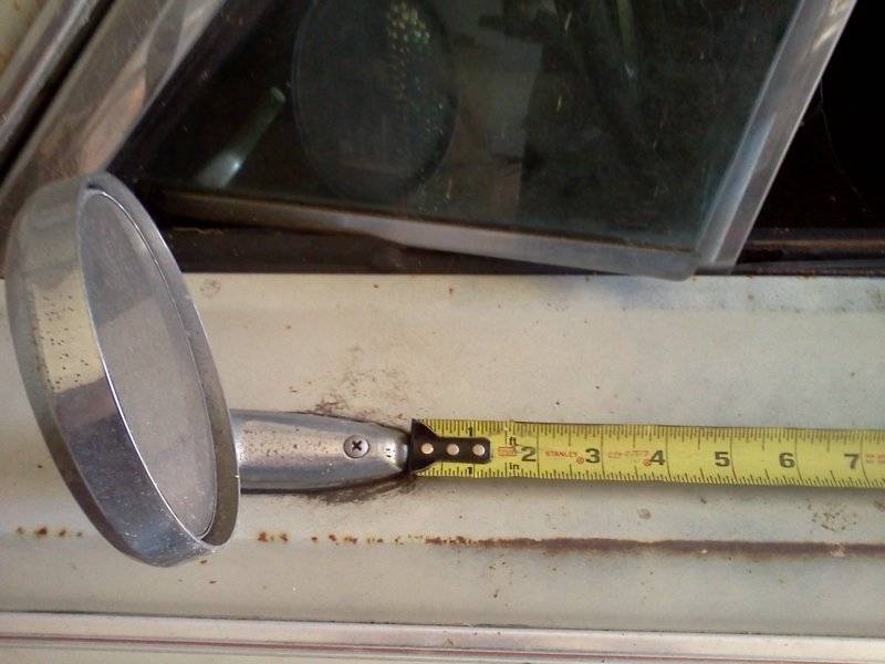

I remember some heated discussions about the location of the passenger side mirrors.
Several folks claimed that they were mounted farther back than the driver's side.
This did not sound right to me.
Here's my unmolested, original paint 67 wagon with factory dual mirrors.
They are both 5 inches forward of the window channel.
I do know that sometime 68-70, they moved both mirrors toward the rear of the car.
My 70 had the lenses even with the window channel.
This made it quite a bit more of a head turning operation, to look at the mirrors, compared to the 66/67 locations.
Does anyone know what year they moved?
I've also read at least one post that claimed the pass side mirror was installed at an angle to facilitate viewing.
That doesn't sound right either.
Obviously that is not the case on this car.
I wish the mirrors on my charger were a little more forward. Im 5'9 and with my seat pulled up the mirror feels crowded.
I had a very original 66 charger and the owner said the pass mirror was dealer installed, worked for a short woman was in a bad spot for me. may account for the variance in location on these cars

Very helpful!!!!! Thank you very much for those pictures, should get me drilling any day now!!

I mounted mine based of the drivers side.

I added a repro right side mirror to my 67.
Pretty much the same location as you show.
I just went with the left side for a measurement.
