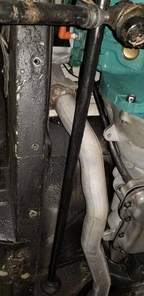

Anyone have a 64 Sport Fury, Fury with automatic trans and the metal splash shield on passenger side? I have 3 tapped holes in frame rail passenger side but no shield. Was there supposed to be one there like drivers side? Inquiring minds want to know.

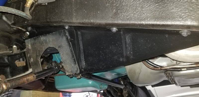

Yep, this one, which is on drivers side.
Anyone have this same shield on passenger side?

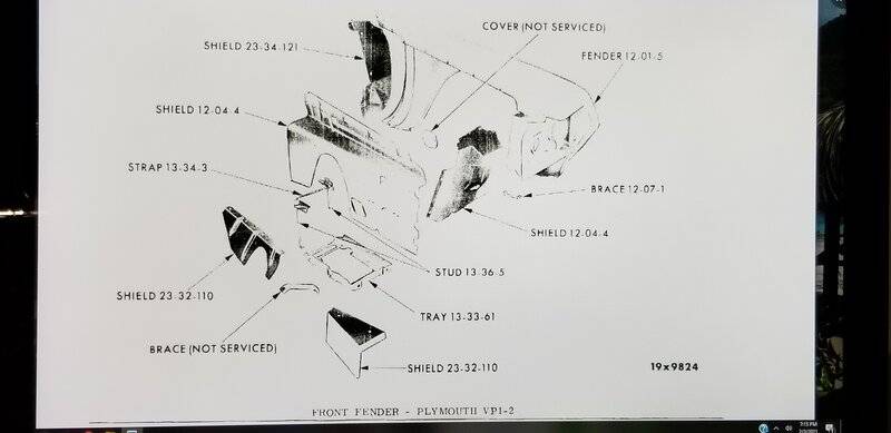

This is from the 64 FSM. This is the driver's side. I have in place shield 23-32-110 as well, both sides forward of control arm.
