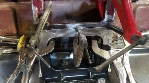

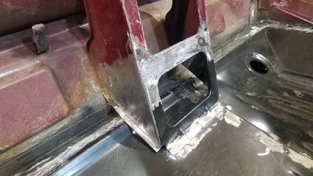

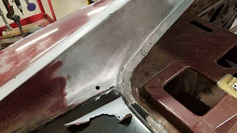

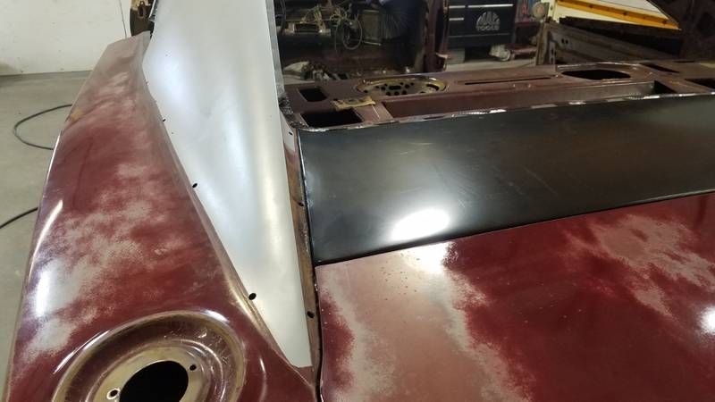

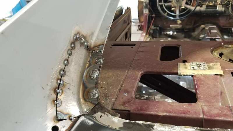

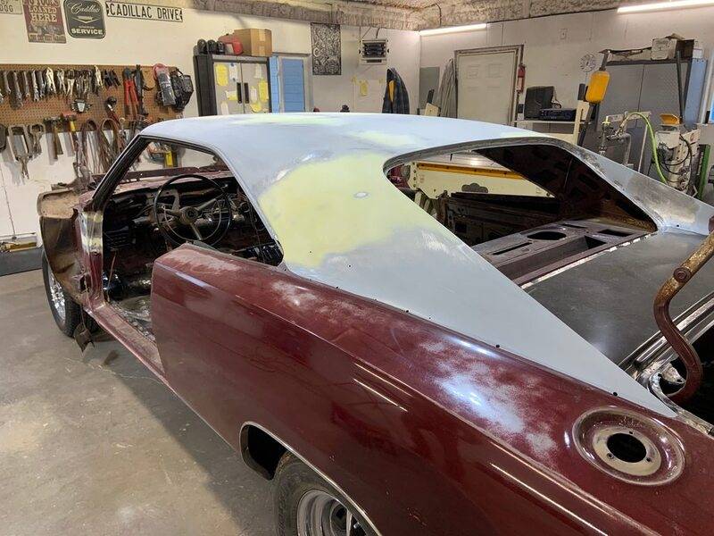

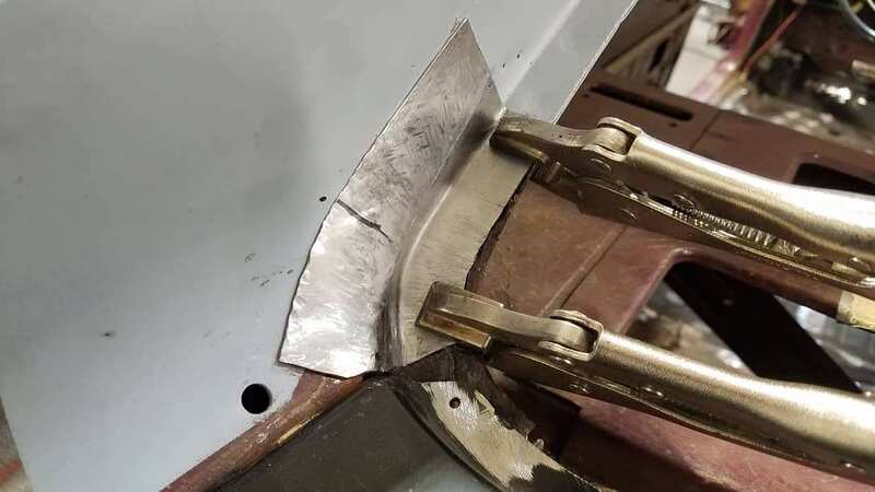

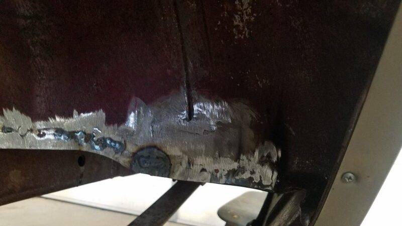

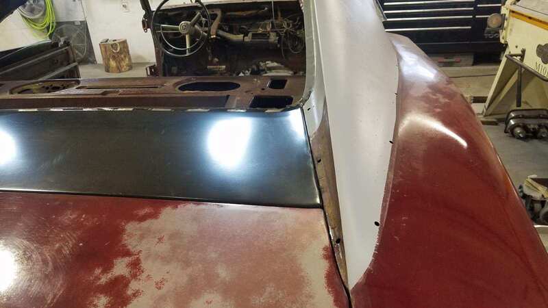

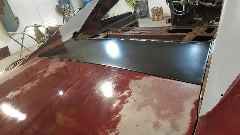

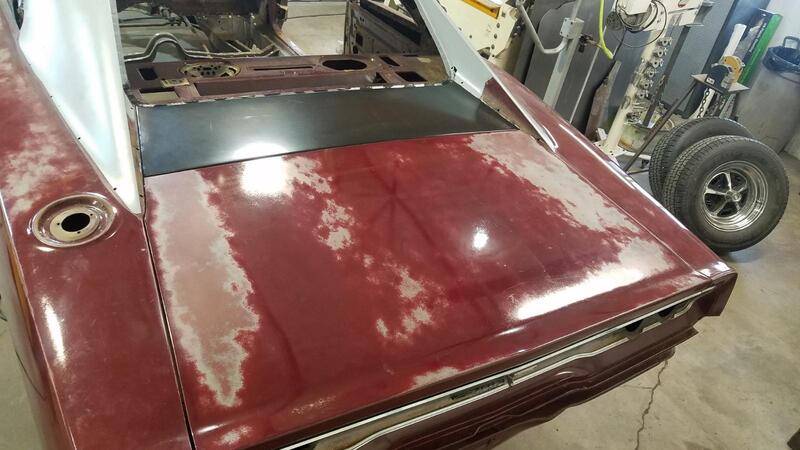

Rear filler panel support and rear filler panel are now installed. The rear filler panel fit better then anticipated. The flanges that are spot welded together needed pulled/clamped together but I am pleased with the fit overall. The first two pictures are of the real filler panel just resting in place. The rest are after its welded in place.

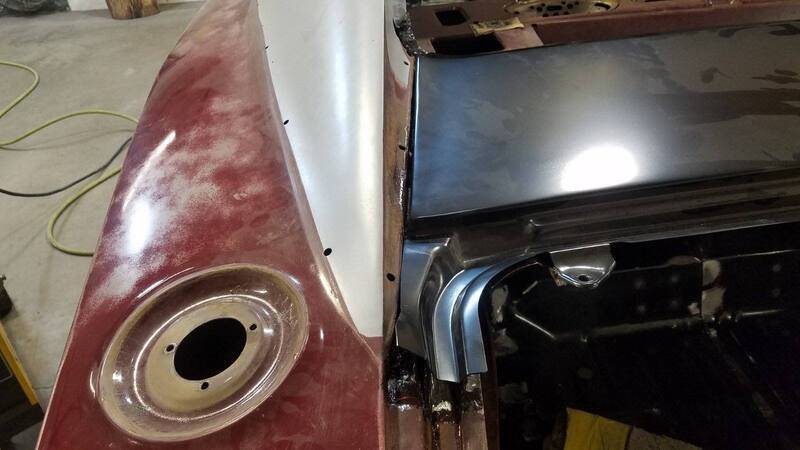

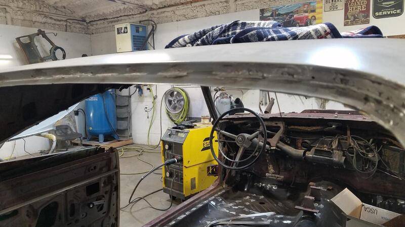

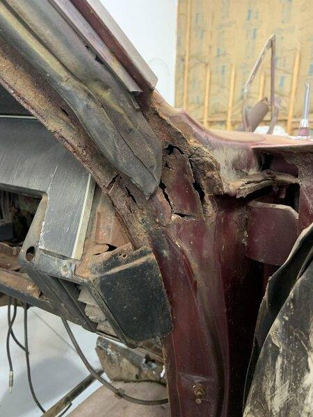

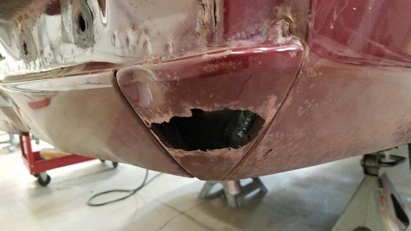

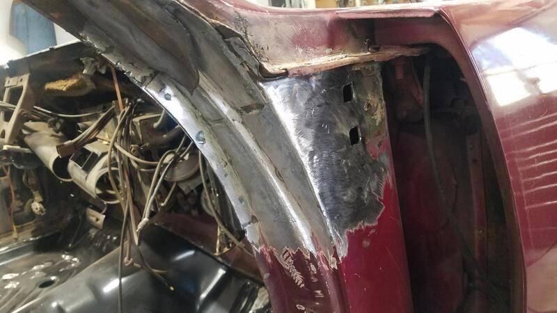

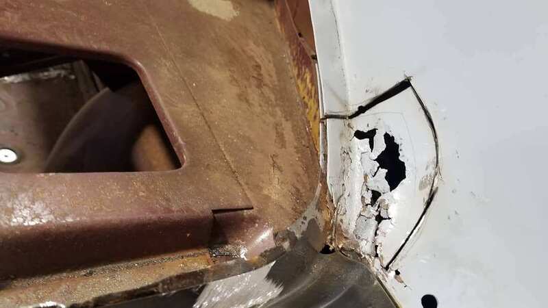

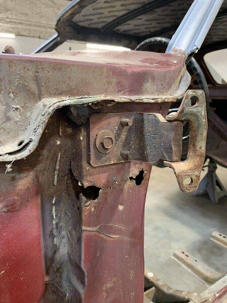

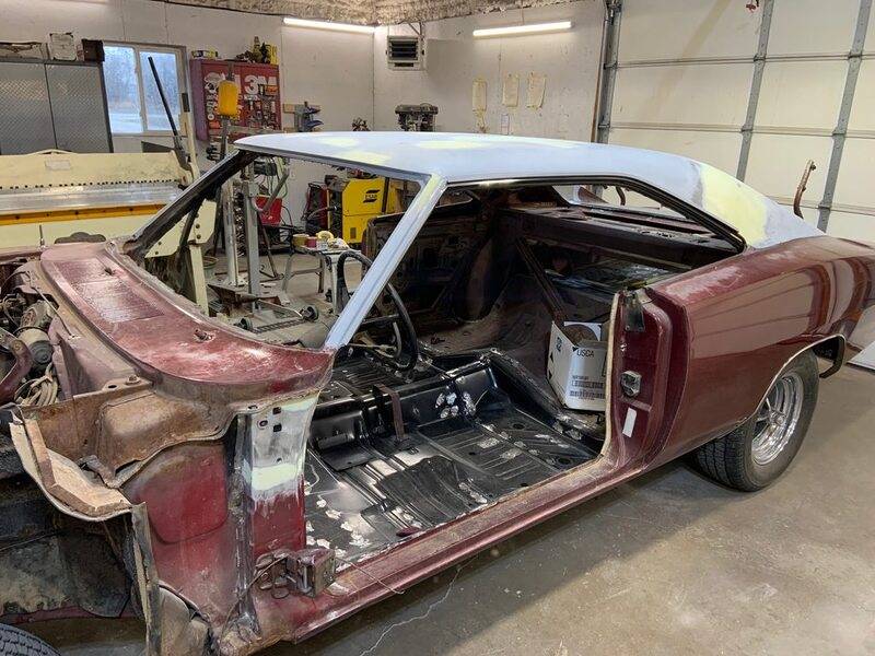

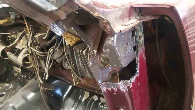

The doors were pulled in order to rebuild the door hinges. Once the driver's door came off, I was a bit frustrated. My best guess is that the poor leading of the upper pillars allowed water to run down the pillars, which rusted out this area below the upper hinge. I called 521 Restorations and ordered up a driver's side post/pillar. It's so weird how such a solid car has rust in such odd places.
The little **** seems to take the longest. Looks great man!

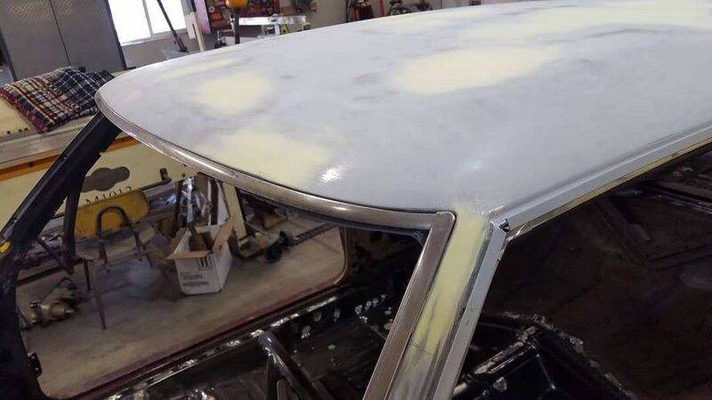

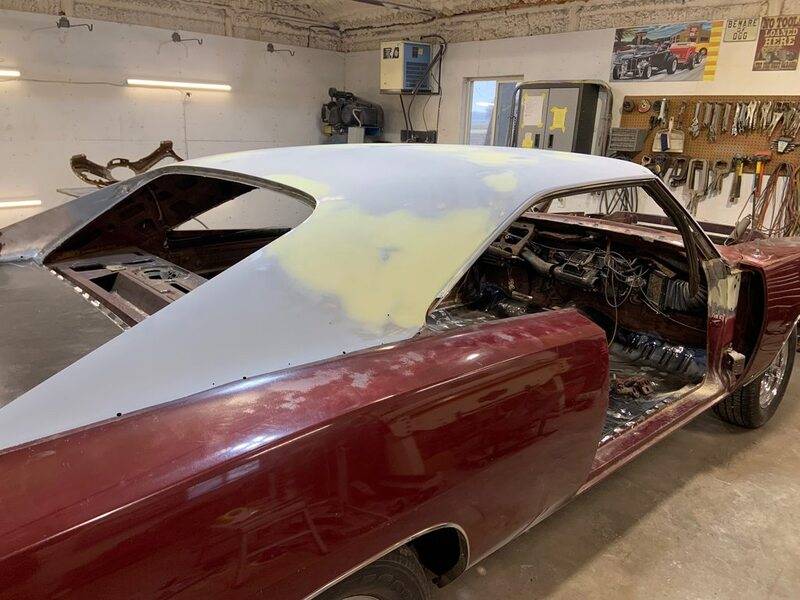

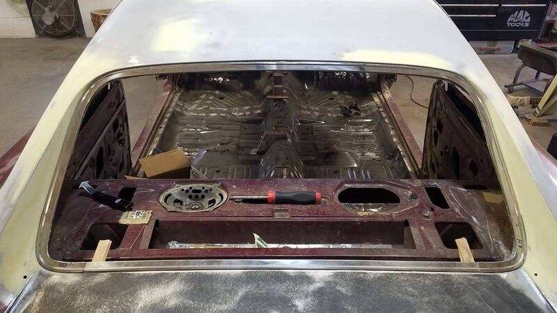

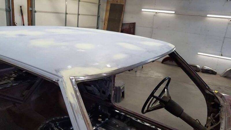

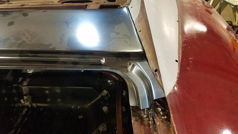

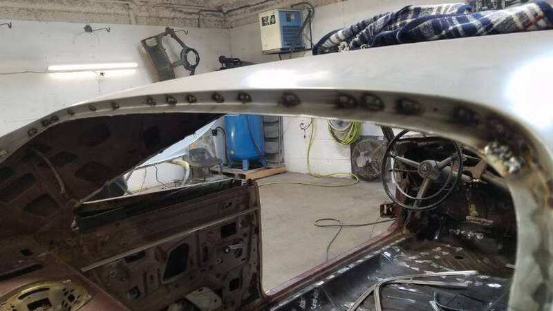

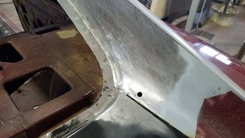

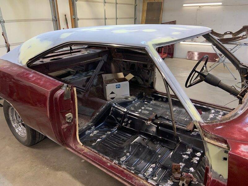

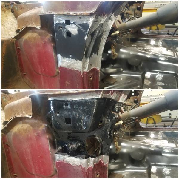

Rear window corner patches and welding up the rear window staple holes...finally done with sheetmetal repair. Bodywork starts soon.
Looks great! I'm doing filler work around the back window right now as well and I'm getting the trim fit on my '68. Did you install the clips on the body and actually snap the trim into place or is it just sitting there?
