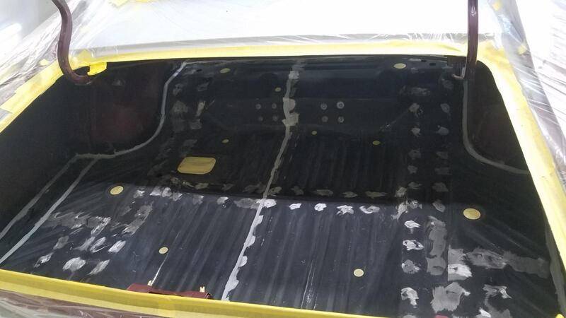

Looks great! I'm doing filler work around the back window right now as well and I'm getting the trim fit on my '68. Did you install the clips on the body and actually snap the trim into place or is it just sitting there?
Trim clips were installed and then trim
Epoxy sealed

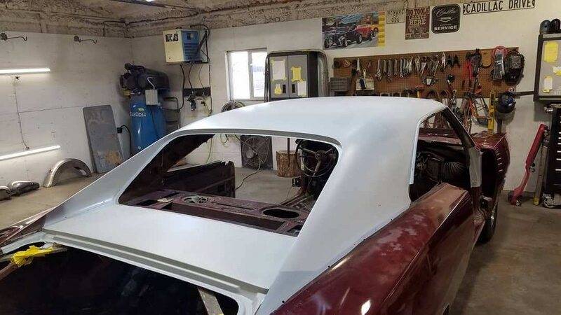

Pillars have been spotted in, door hinges have been rebuilt, and doors have been hung (and they close so nicely now). Now that the doors are in place, it makes me appreciate the work the PDR guy did to remove the dings!

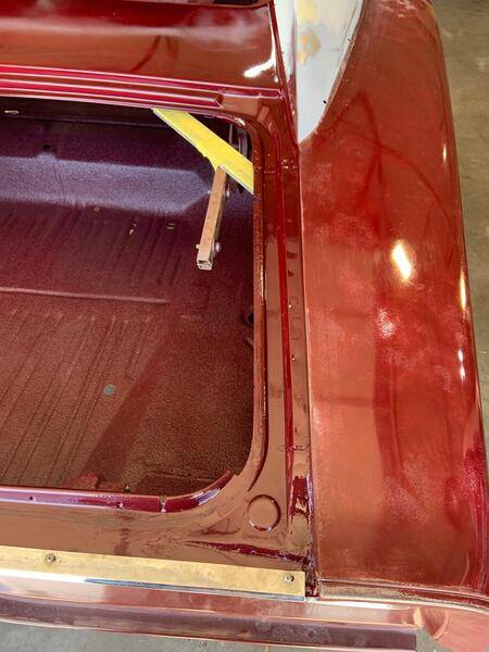

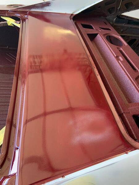

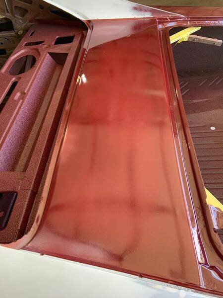

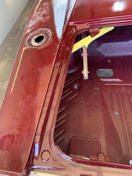

Trunk gutters and rear filler panel have been painted. Rear filler panel was deliberately sprayed thin in areas, to mimic the patina of the original filler panel. I'm pleased with the color matching

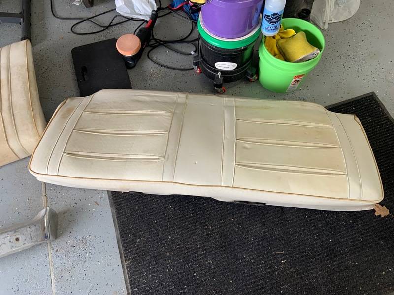

I have been slowly picking away at interior. I have a new Legendary carpet that has been rolled up in a box for 13 years, so it is taking lots of time to form it to the floor pans....hence the sand bags in the picture. The rear upper seat had a clear plastic cover on it that was half on/half off, which is why it has a dirt line that runs from corner to corner. The rear seat cleaned up pretty well, but has some yellowing/staining.
I know its not correct,but a white vynal top would really pop with the white interior and that color!

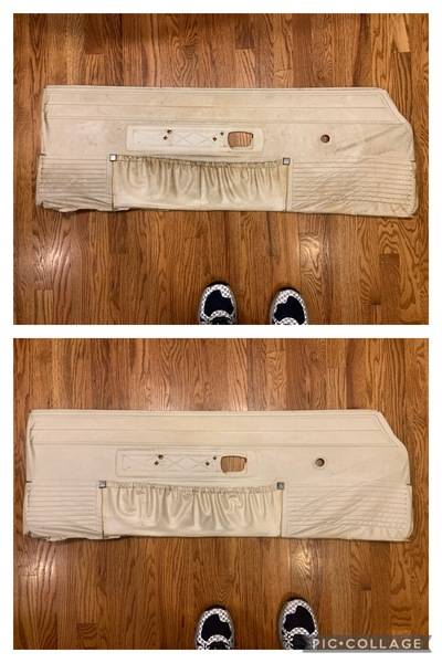

I also cleaned up the door panels
