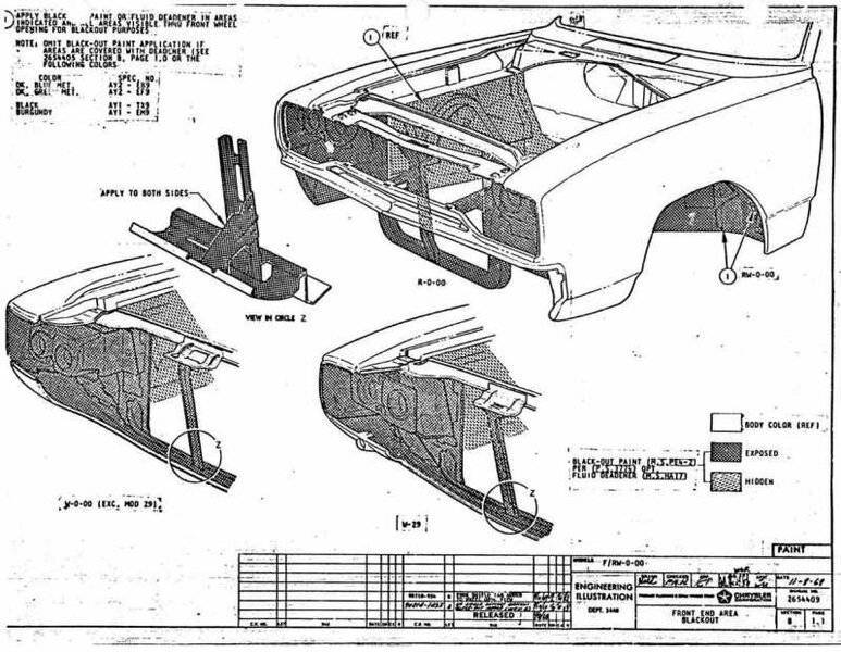

Also, I noticed that there is not blackout treatment on the front of the radiator support...and the radiator support has not been repainted.
I do t believe the core supports were blacked out on dark color cars?
I think it’s going to look great!
Dark green, dark blue and black cars were not blacked out according to things I have read. This should be 66, 7, 8,9, and 70. Don’t know about later years.
At least on this year, dark green, dark blue, black and burgundy did NOT get blackout....

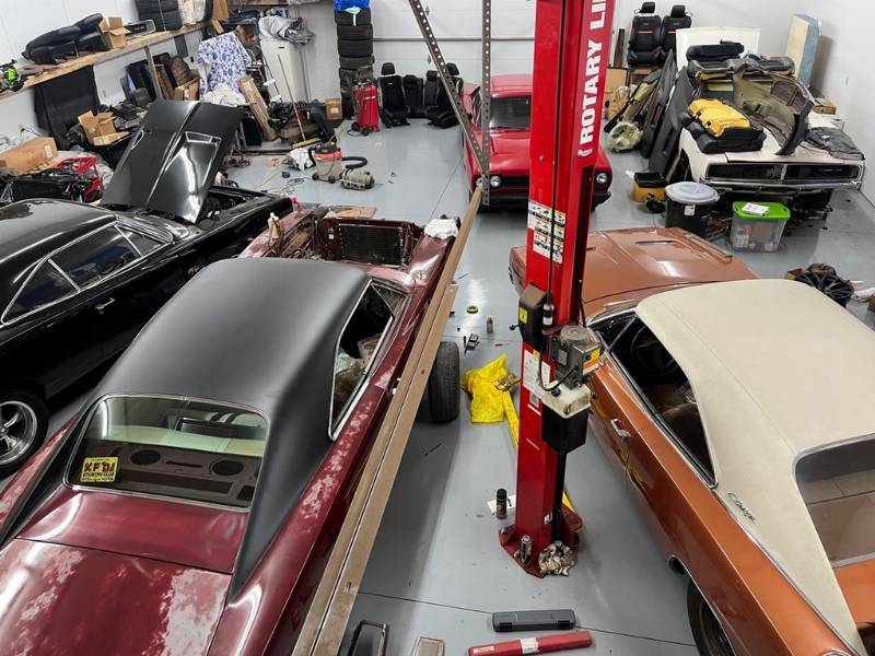

Got the Charger up on the lift to mock up the drivetrain...

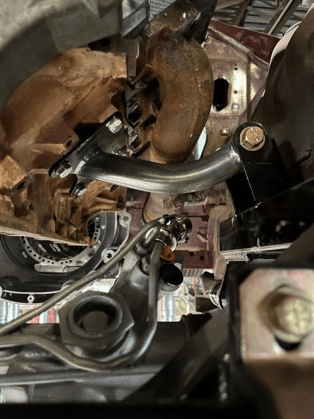

Mounted the cast manifolds first, which are from a 6.4L Jeep Cherokee SRT8. These headers are cheap and they actually came factory on Jeep SRT8's which had 485hp, so they can handle the power and won't break easily. I paid $125 plus shipping for them. The driver's side engine mount had to be redone to accommodate the cast headers. The mount was originally straight...now it is curved.

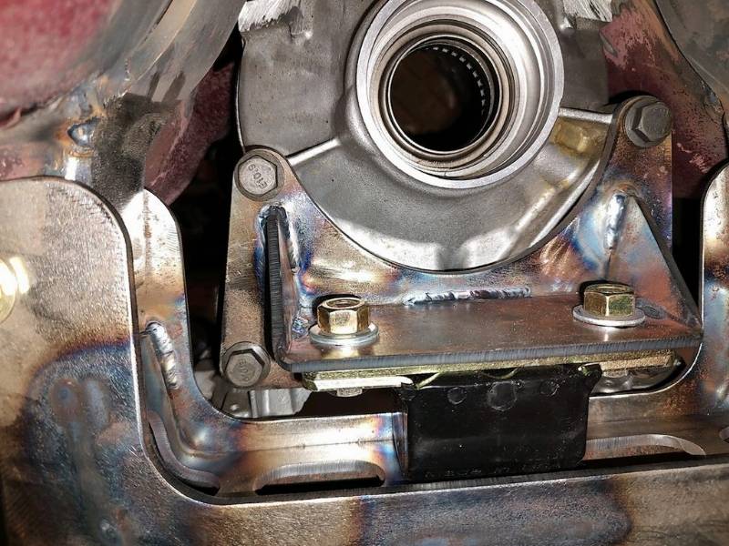

It's kind of hard to see in these first two pictures, but the tunnel had to be clearanced to get the transmission up into the tunnel where it needed to be.
The torsion bar crossmember lips were trimmed down in the tunnel and a plate was welded in.
I'm a little curious about the engine mount.
It looks to me like the bolts to the block are in serious tension. All the weight is trying to pull the lower 2 bolts out of the block. The banana curved section should be turned the other way with the outer mount secured lower in the chassis.
Am I wrong?

While I agree it would be better if the mount carried the load down rather than out the fact it's the drivers side so under power it's pulling up rather than pushing down it'll probably be okay... The fact it's an iron block helps too... Aluminum blocks tend to distort more than Iron blocks if you do anything that changes the stressing of the block...

The mounting flange (that goes against the block) and the mount to the K frame are the same as they have been for however long Reilly Motorsports has been building them. Only the tube in between is different...With four bolts holding it tightly to the block it shouldn't be in sheer...and with torque rotating/pulling away from the mount, it shoudln't be an issue. If it was the design would have changed. RMS knows what works.
Thanks. I don't trust RMS as much as you.
