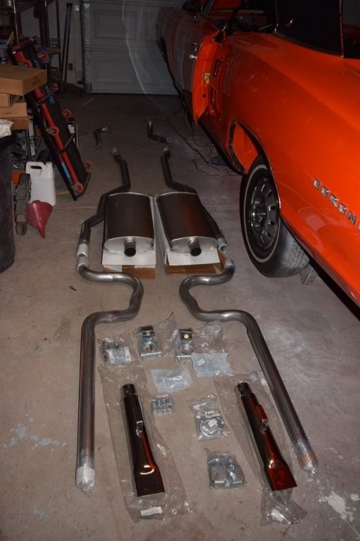

Went with dual Accurate Exhaust with Hemi Mufflers...
