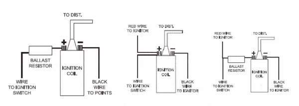

Just got the ignitor in the mail.I was reading the instructions it says I need to wire it on the ignition side of the ballast resistor.Is this true or can I just connect it straight to the coil?
You have to bypass the ballast resistor. Either run a short jumper between the 2 connectors on the ballast resistor or solder a jumper on the back side of the ballast res.
Like the three pic?
Well, kinda..... basically when you run a jumper between the 2 posts of the ballast resistor you are connecting all of the wires on it together so you get 12 volts to the coil at start up and also when running. The purpose of the ballast res. is to reduce the voltage to the coil/points to increase points life. now with the electronic conversion you don't need the ballast res. but just all the wires on it connected together. I like to retain the ballast for looks but still bypass it. Now that you have it bypassed you can use the original wire in the harness going to the + side of the coil to provide power and run both leads of the Pertronix to the coil also. Red to + and black to - of the coil.
