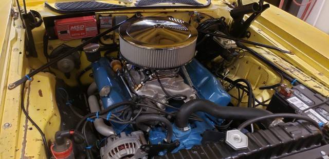

Picked up an Edelbrock Performer 383 intake

Is it a better intake than the factory 1972 cast iron spread bore intake thats on the engine now? Engine has iron heads, mild Erson cam, long tube headers, and 750 Pro Form DP.

Results are in. The Performer 383 is a much better intake than the stock 72 iron spread bore intake. In the upper RPM range the engine pulls much harder, enough to feel the difference. Normal driving is about the same. Very happy with it for the small $125 investment and some clean up time.

Not really. I reused the old metal gasket, just snugged it up tight, and it didnt seal. Had eratic idle. Propane test showed it leaking around the ports. Checked the torque spec, should be 25 ft#. Torqued it down in 2 steps. Then it sealed up.
I need to tweek the carb now a little I think. In the short drive I have done there seems to be a flat spot when the secondarys open. I increased the squirter sizes with the old intake, putting them back to stock now. Still need to test it out and see what AFR's are across the RPM range. Getting rid of the wonky restrictive spread bore to square bore adapter plate on the original manifold, and having a 1" open spacer on this manifold may make a difference.
