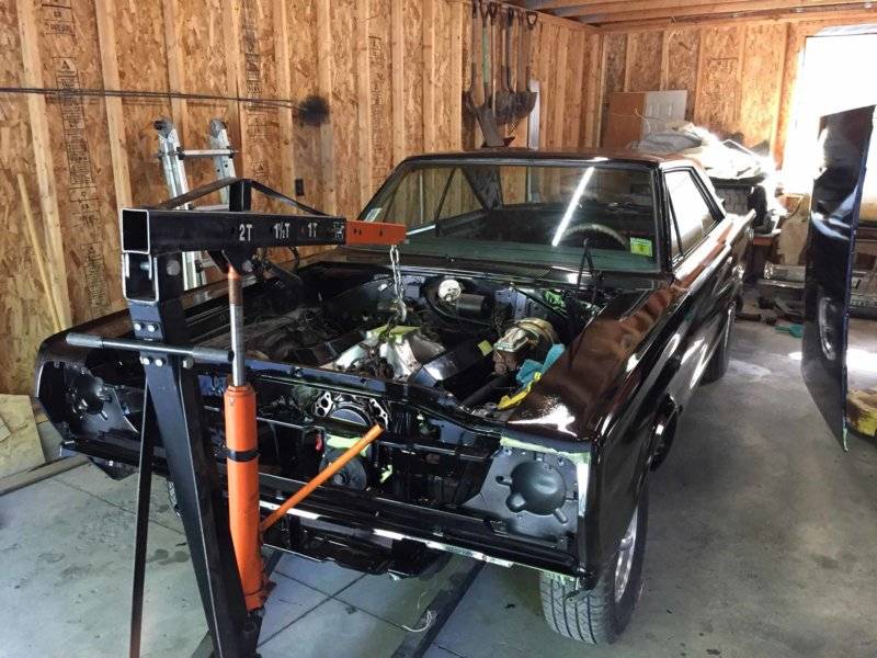

trying to pick a rear gear for the zf s6-40 which has double OD. car will see lots of highway and I like not constantly pulling gears on the street! what gear 3.91/ 4.10 or ?

it's not tubbed!keeping the tires hooked is #1 in my opinion! these cars won't fit much rubber under them! that's why I'm thinking longer pulls with less tire contact disruption!
