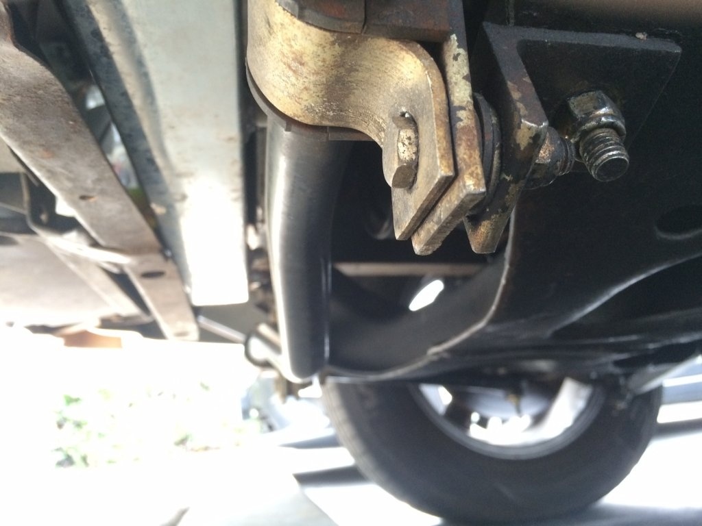

I'm looking for some pics of the Hotchkis front sway bar and how they attach to the K member. I know its a weld in deal, but I'm trying to determine if I even have the hotchkis bar. Right now it's bolt on sideways which doesn't make any sense unless you saw a picture. But it seems like it sticks out too far past the k member to even work. Anything will help!

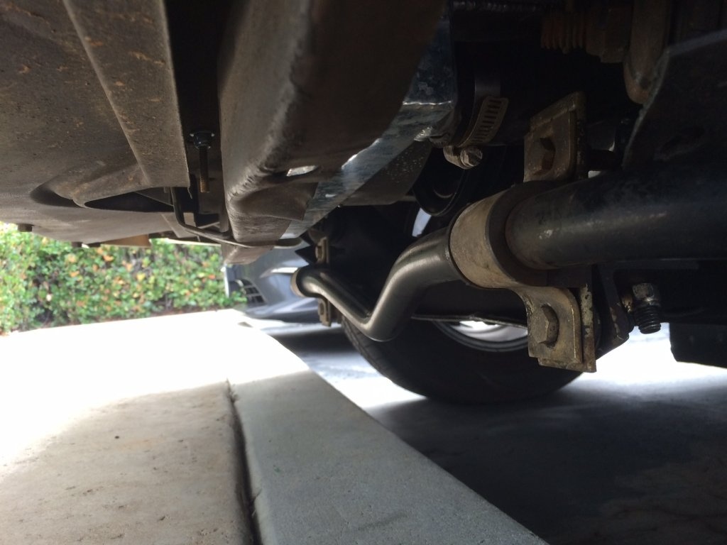

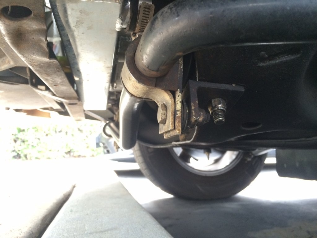

Ok here are some pics. Maybe once the "brackets" are unbolted the sway bar will push inward a little more?
I dont have a pic handy but that doesnt appear to be Hotckis. I just intalled mine this weekend on a b body and the brackets and curvature in center of bar do not look correct.
I have a front bar and mounts on a car I just picked up that looks very similar to this. It doesn't look factory.. Which is fine, but I have no idea what it is.
Looks like looks like mine. I have a pst solid bar setup and it just bolts to a hole on the k frame lip. But the hoop should be up as it's there to go over the lower road support bracket to the grill...
