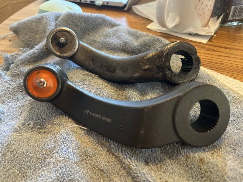

Hey all, I had to replace my pitman arm (power steering) I got a new one, put it on and it won't line up to the center link properly.
It can only go on one way, that is if you want it to face the proper direction (due to the 4 splines).
When it does line up, the steering wheel has to be turned extremely far in one direction. What the heck did I do wrong?

What is the part # of the pitman arm you purchased? Did you center the steering wheel/ steering box? Did the new arm compare to the old?
Here ya go. And the splines seem to match up on these Pitmans. I’m going to count the teeth in between now.
