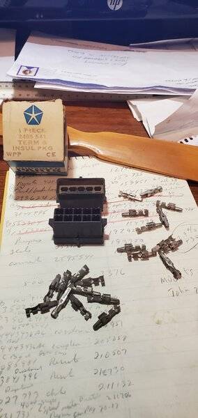

are these what you are needing?
i was not sure if these carried over into later years or not. i have 2 boxes of these on here for sale. if iirc they fit up to 67 or so but that is where i stopped looking. thanks 451mopar
Those Twin lock terminals are nice to have if re-wiring a car with one of the generic wiring harnesses.
The Ron Francsis kit gives you new terminal shells to convert to Packard 56 type terminals, but I would rather use the stock connector with the twin lock terminals than cut a perfectly good end off a reproduction turn signal switch that costs $100+

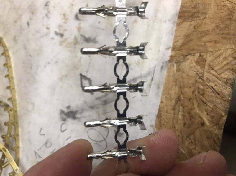

I ordered the molex pins in .062 and .093 as there are two sizes in the ignition switch connector. You have to leave a certain amount of that “chain” material on each side of the pin as it keeps the pin from pulling through the connector. Learned that one the hard way lol.
I know what your saying. When I first crimped (I think it was a Packard 56) I crimped the tangs that stick out the keep the terminal from going too far forward in the connector.
