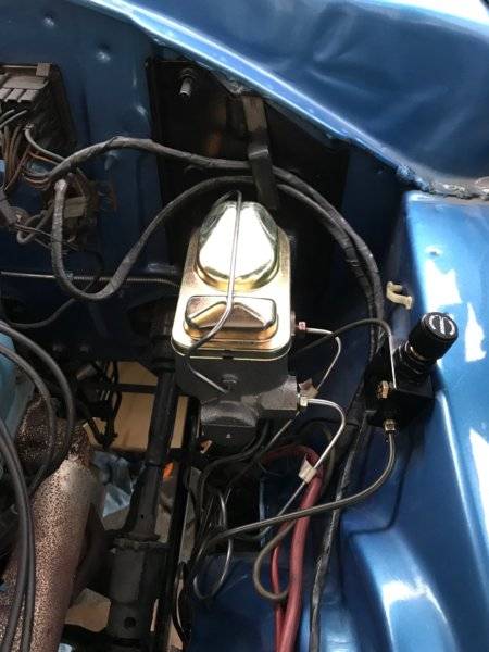

Pedal is very solid, not spongy at all. I made sure to bench bleed the new M/C thoroughly and flushed all the brake lines with new fluid. I also rebuilt the rear drum brakes completely with new wheel cylinders too. Don't forget that if you have front disc and rear drum brakes you have to plumb in a proportioning valve into the rear line so you don't get rear wheel lock up. I put mine in-line coming out of the stock distribution block to the rear line and mounted it up on the fender near the M/C in an existing hole to make it easy to access during adjusting. I just needed 2 30" ready made brake lines and a coupling to connect the line out of the prop valve to the rear brake line. Had to make a couple of loops and bends which you can make out in the pics below.

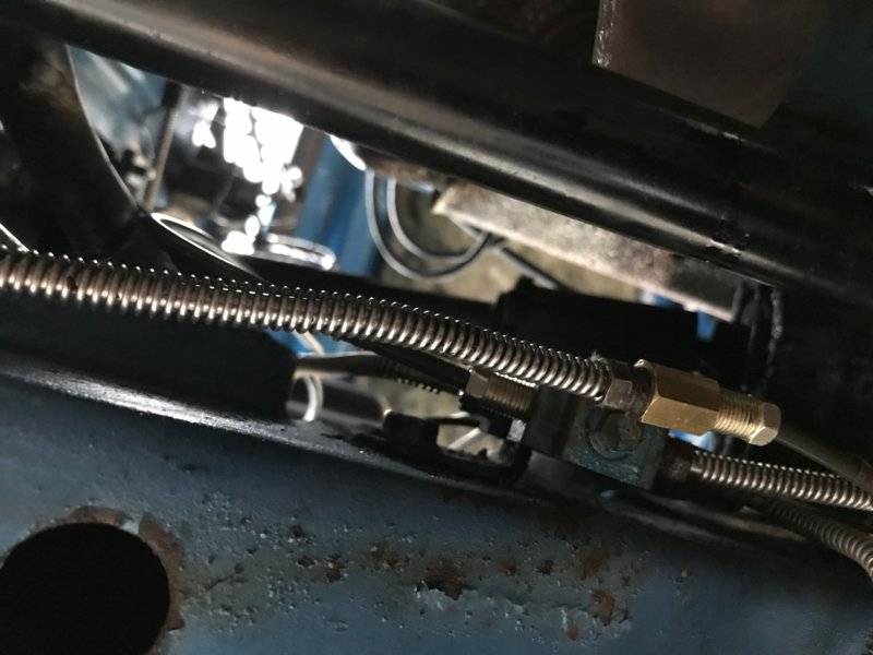

Your system looks nice! I installed my P valve in the rear line right under the driver's floor. Still pretty easy to get to and much less plumbing. I just cut the line, double flared new fittings and connected to the valve.
