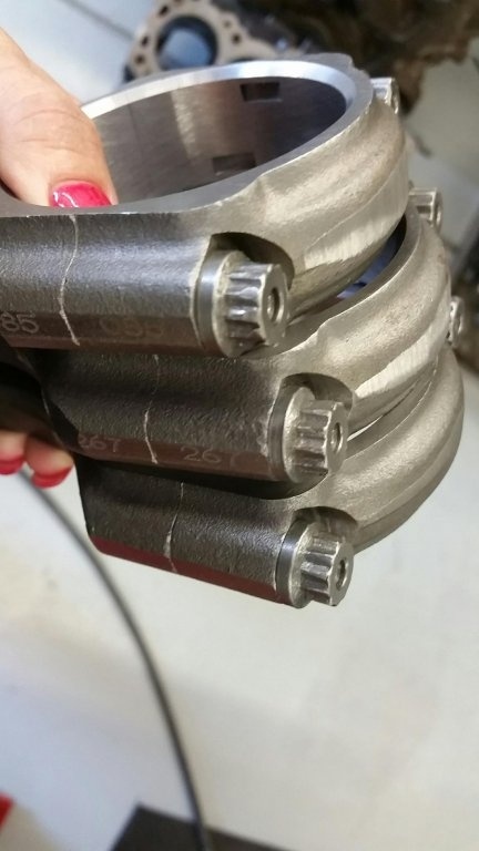

My rod caps on the last set of 440source rods I bought for standard stroke 440 with 1.094 pin. Replaced the rod bolts with arp and had the rods resized.
Would have went a different route but time was of essence.
lol thanks guys but that's my machinist daughter who ports heads for Mopar's engines west
