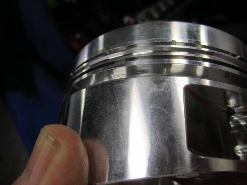

They all measure just short of 4 3/8ths both top and bottom. As far as round goes the piston has the same clearance right side up or upside down at the bottom of the bore. Sorry, I don't own a digital caliper. Just a regular one.
If you mean the "Three Fingers of Death" flex hone, I suggest you either throw it away, or sell it to some other sucker. That is the worst tool to use to deglaze a cylinder. A ball hone will NOT remove enough metal to change the shape or enlarge the hole. If you are already at 0.008" clearance, I suggest you have the block measured by a shop, and size willing, hone it to 0.040" os using new pistons. With all of the money you have spent so far, why shortchange your project now! Have a shop determine the oversize required, get new pistons, and hone (0.040") or bore/hone (0.060") to make the cylinder round and straight. New cam bearings, tower bushing, and freeze plugs should be replaced too.
No, I know better than that. I mean a ball flex hone. Plus your talking about $1200 worth of machine work I cant afford.
If it just the one cylinder,clean it up,see what the old rings measure and go from there! Keep it within budget so you don't miss the whole season!!
1/16, 3/16, and 4 3/8ths. Ring thickness, ring width and bore size.
pretty sure those are 5/64" ring grooves for the compression rings; 3/16" oil ring. thinking about it, I think your measurements are off.
double check some things. a 4"-5" mic and a dial bore gauge will get you on the money. calipers won't work. another thing you can try is feeler gauges between the piston skirt and cylinder walls. not real accurate but I bet you can get closer than a caliper.
.008 fits inbetween.
So it sounds like the motor was already bored .060 over. Given that, it ran OK before you tore it apart and most importantly your budget.
