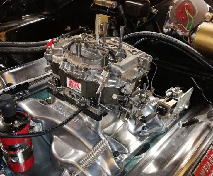

Please educate me on 727 throttle pressure. (I have no kickdown)
Jonas Nordstrom
3:43 AM
Nov 12, 2019
566
511
Sweden
Ok, I very carefully installed my wire set-up on my 727, making sure the hole on the carb lever was exactly where it should be (I took the special mopar bouchillion throttle plate to double check with.)
I tested several arms (Different lengths) down on the throttle lever on the 727.
I got a perfect ratio adjusted now when the pressure lever almost bottoms out when the carb lever is fully open.
The 727 changes gears just when it should at the right speeds. No slipping etc.
Though I have no kickdown...
Is it time to remove the oil/cover on the 727 and adjust inside there?
(And what/how do I adjust that?)

It is set at idle (barely touching where you start to feel resistance in the throttle lever.)
And then the best change gear adjustment was when the KD lever is about 1mm from bottoming out when the carb is fully open.

I thought the cable adjuster could fix that but maybe there is something else with the ratio that changes moving the attach-point rearwards?

I do have it right at where the pressure starts in the KD lever.
Changing gears is a nice "tug" at the correct speeds.
(Dont remember the speeds now but I found them online when adjusting. )

Could I have damaged/bent something in the valve body when testing?
For ex having the cable too short so the KD is bottoming out before fully open carb?

Damnit, I have been adjusting like crazy at WOT.
...starts to feel like its the starting point that is wrong.
What could be the next step, shorter lever down on the box?
