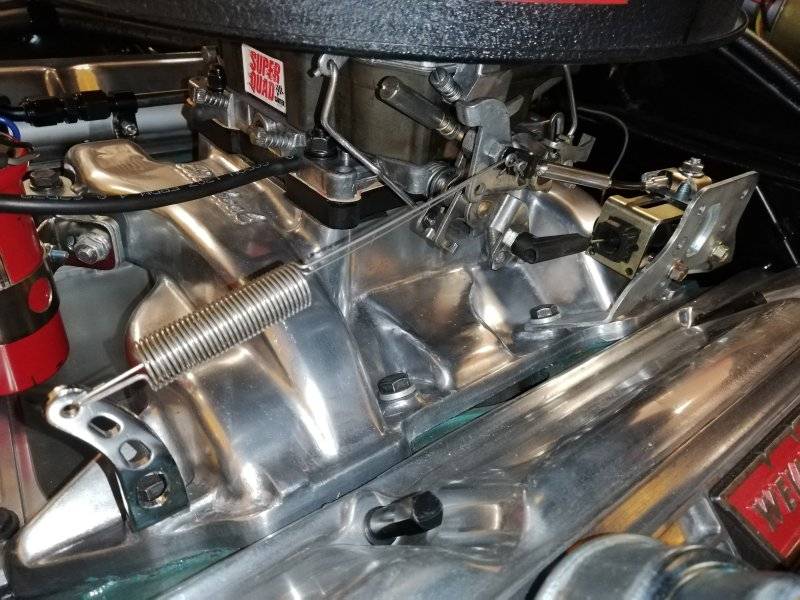

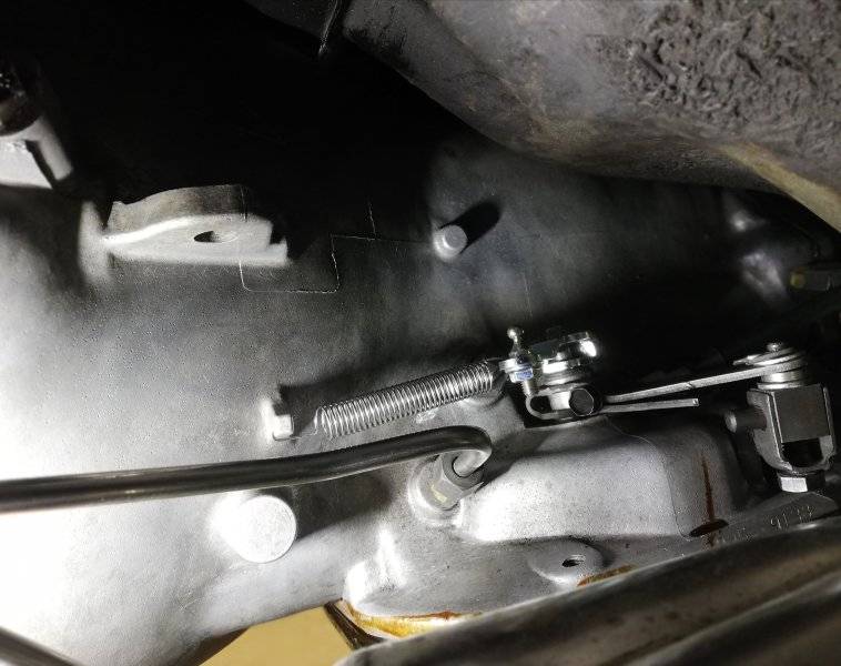

any chance you can post a few photos of this? I'm surprised a spring would work better than a cable. Both stretch a bit don't they?

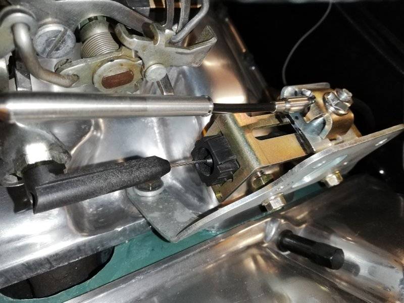

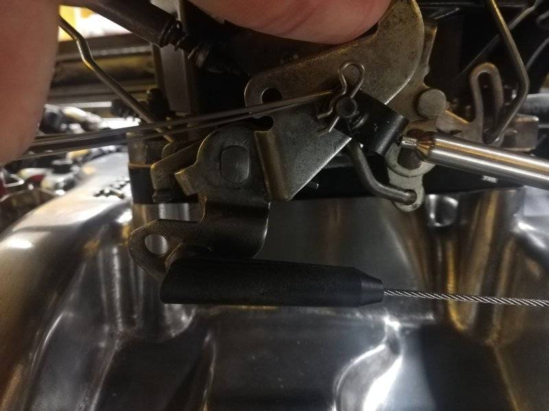

I'm no expert, but shouldn't your return springs be connected to the lower hole in front of the cable attachment shown in your photo? Not that this is contributing to your issue. That's the same cable I have on my car. Let's see a photo of your cable clamp. Lock it in and use a blue or purple sharpie to mark it on the the clamp so you can see if it's slipping when you push the accelerator. That thing needs to be pulled back hard towards the firewall to engage the spring (not to WOT) then lock it in good.
Return springs are connected at the throttle cable pin as they should be.
Kick down wire is clamped down hard and was marked with a black sharpie.

great photos, thanks. The bottom cable is the one I'm talking about moving back more, not the top one. That's my one gripe with this Bouchillon setup - I wish each cable could be locked down independently.
