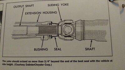

I had a short d shaft that killed the bushing. There was .012 clearance between bushing and yoke. This is what I have now (see pic weigh on wheels) with the length d shaft SM calls for. Have a d shaft 1" longer also, looked long when installed.
With the weight on the wheels I have almost exactly what you show in your pic, about 2” exposed from the seal flange. Is the pic a pic of when you had the problem or is it a pic of the longer
driveshaft?
driveshaft?
See post 11. With the long boot seal like you have, there shouldn't be more than 3/4" of the shaft exposed from the end of the seal.

I had a 8 3/4" driveshaft in my 70 440 6bbl Dana 60 car. That little bit too short of driveshaft length made it vibrate at highway speed. So...

Had 68 GTX with a Dana 60 d shaft in which caused the problem 1" shorter than picture. http://www.mymopar.com/index.php?pid=31
Download a manual for your car and look in prop shafts this what you'll find.View attachment 1032470

I checked again with the weight on the car. My yoke is exactly like yours, 2” from the seal flange to the big part of the yoke.
My shaft is stock, I measure 52-1/4 which matches the chart. It has the tone ring weight and the rear necks down slightly to meet the small 7260 yoke. It was spun balanced by 2 shops, both said its perfect.
