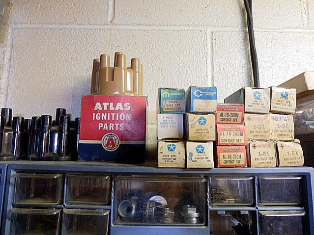

thanks, but Cranky is the wealth, he just let me know what I've been doing all these years....:laughing5:
