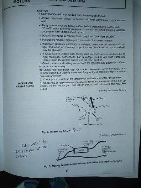

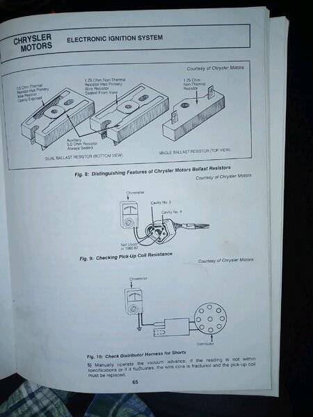

If you have no flicker then you have no spark out of the coil, the pickup in the distributor is what makes and brakes ground causing the coil to discharge. Set your reluctor gap to .008", think you mentioned you did that already. Ohm out pins 4 and 5 at the ecu 5 pin connector and verify resistance through the distributor( leave distributor 2 pin connector hooked up) ...should read between 150-900 ohms..
Here..
20210129_100639.jpg 20210129_100734.jpg 20210129_100814.jpg 20210129_100849.jpg 20210129_100922.jpg 20210129_101019.jpg 20210129_101050.jpg
