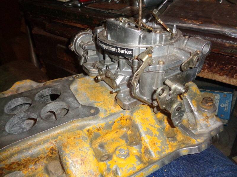

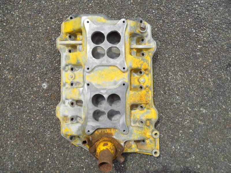

just need some fuel and air to make your poly run , how about this ? and afb's fit it .
what ? well i'm not sure yet , lol . i've had many poly intakes over time three duels and twin fours a couple times now . but i don't have any poly engines , lol .
