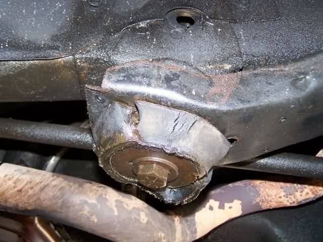

I am installing a set of "Pro-thane 4-101-BL, Chrysler Sub-Frame Mount B-Body 73-81" today. The originals were completely rotted out. The first one I did I pulled the bottom part of mount off without even touching the bolt. I have only installed the driver side so far. Hoping to complete this evening. I purchased these through Summit Racing for $51.95. About half the price of Energy Suspensions kit. This should really make a difference in the creaks and groans I've been hearing. Should also improve handling a ton. Will let you know how it feels after. Be glad to help with any questions if anyone does this job too.
This is what they looked like before.

Well, Hell yeah, C. I'd sure like to know how easy/hard they were to install. I know my 'Doba is never gonna be a rip-snortin' 1000 hp monster. But it WILL be a proper-handling, 370 (-ish) hp driver. The urethane K-frame bushings are right up my alley. I've been vacillating on whether I want to rebuild the front suspension with OE rubber bushings or upgrade to urethane. I'm leaning heavily towards urethane. It looks like you didnt have to disassemble the suspension to put your K-frame bushings in. Cool. Did you have to lift the engine some to get the weight off? I'm guessing jackstands under the "frame"? Did you put another jack under the K-frame? Let it down slowly? Any weirdness or trouble? Mine's still up on stands so maybe I'll order a set and put em in before I drop it down. Thanks C...3. JY
It wasn't all that horrible. I did not have to disassemble driver side suspension. A bit of prying and a few good whacks with the ball peen... On the passenger side I did have to separate the upper balljoint and pull the four control arm mount bolts to gain space to get bushings in. Not the ones for the alignment but the ones underneath the control arm. You must back the torsion bars all the way down for this. Jack under lower control arm and let down easy after everything is loose. you will gain room to insert bushings.
Probably would be easier to do both sides this way. Take the body mount bushing bolts one bye one, all the way out and run back in a few threads. change one at a time. On one of the solid bushing sites it called for 85 ft. lbs. torque. I may be wrong on this but I put 100 ft. lbs. Any more questions I will be happy to try and answer.

I did have a bit of trouble. Lowering the K-frame, I put stress on the power steering pressure hose and sprung a leak. might want to take hose off on one end or the other.
