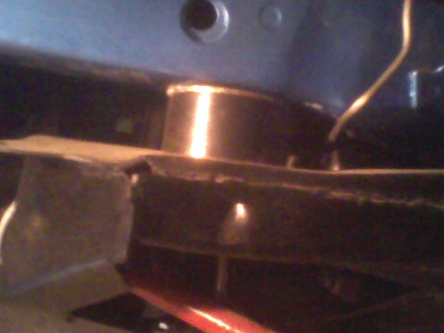

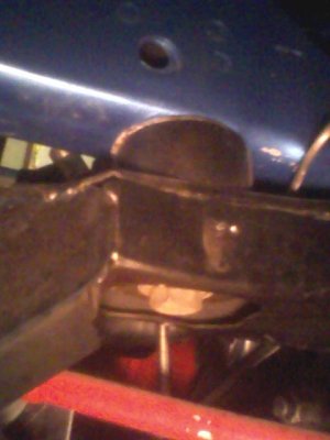

its not the bolts you need to worry about, it is the welded nuts inside the frame rails that snap off if there is excess rust and corrosion. there are little holes in the frame rail that you can shoot penetrating oil into and on top of the bolts where they come through the welded nuts. do this and let it soak. when you go to loosen them , ease into it with a cheater instead of shocking them with an air ratchet or the like . you don't want to break one of those nuts off inside the frame rail
