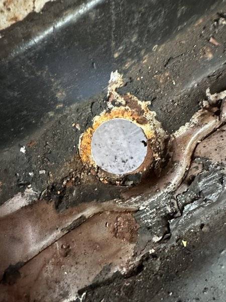

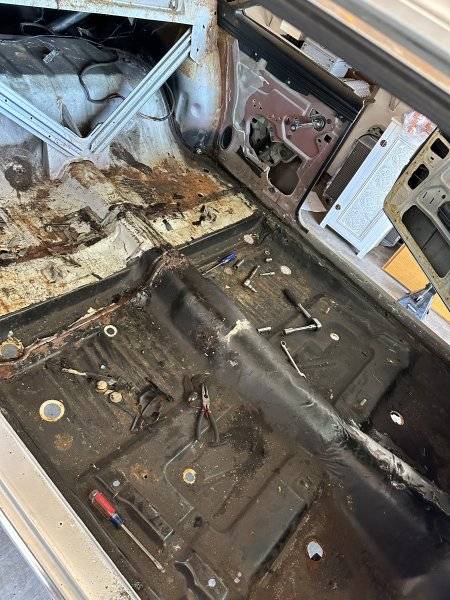

Here is the por 15 nightmare I’m dealing with from the previous owner of my Swinger. You can see where the por15 peeled up when I removed a body plug. I know the the PO did an absolutely terrible job on prep, but I’m not sold on the POR15 anymore.
