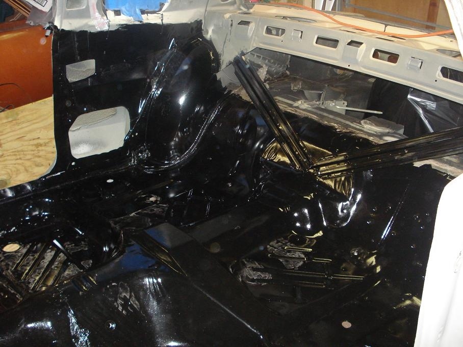

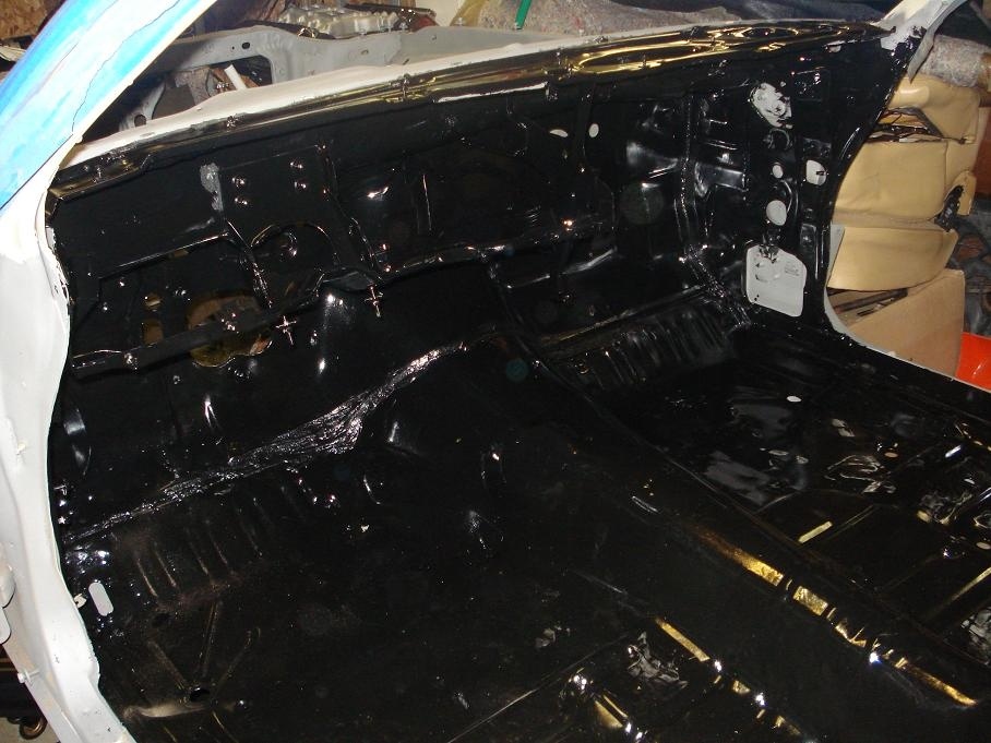

I did mine, I figured why not? Since then I have been disappointed in the performance of POR-15, and might look into something different if I was doing it again.
