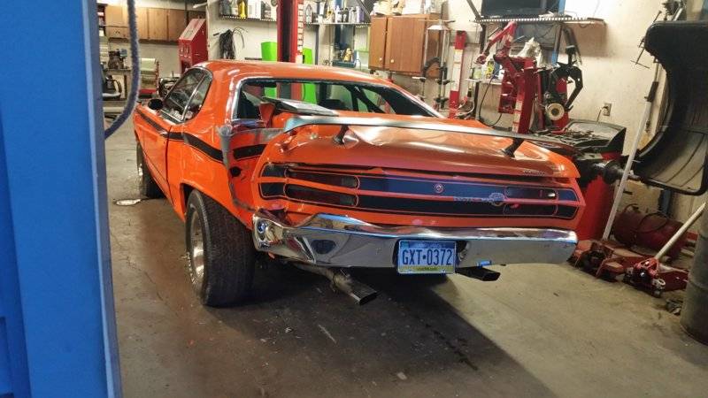

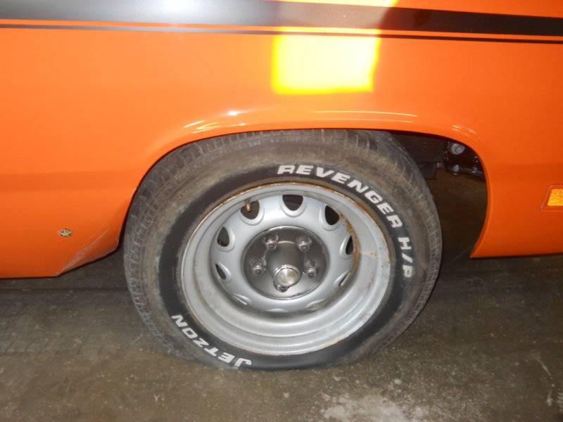

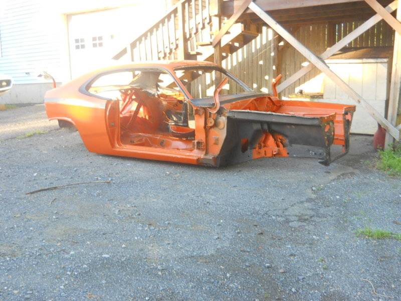

I lost a car over a chinese upper control arm eccentric bolt. You know the ones with two flats instead of one. I had the old ones but I used the nice looking clean new ones.

Bolt break or flat tire or both?

Threads stripped on the bolt. Eccentric moved. Foot braked the car at the track with front runners so it could have moved then also. These tires were on the car from my Roadrunner for the winter months in the trailer, Took the car around the block and the tire came back hit the fender and cut it. With a spool in the car it went hard right. That was the end of that car. Insurance paid for the car but I had it since the 70's. I miss the old girl so I keep it sitting out back.
