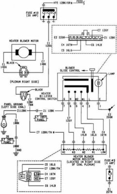

Heater fan on constantly.

Sounds like your resitor bank to your blower is shorted to ground on the blower asembley

The heater blower is relatively straight forward. Black/Black Tracer, power from fuse block to the blower switch. All other wires (Red, Dk Green, Lt Green) to the heater resistor. If it worked properly before the new harness it's probably just a connection error.
http://www.mymopar.com/downloads/1968/68CoronetA.JPG
http://www.mymopar.com/downloads/1968/68CoronetB.JPG
Don't let drawings intimidate you. If you can read a map, you can read a drawing. Your just trying to get from point A to B. All those other lines don't matter.
