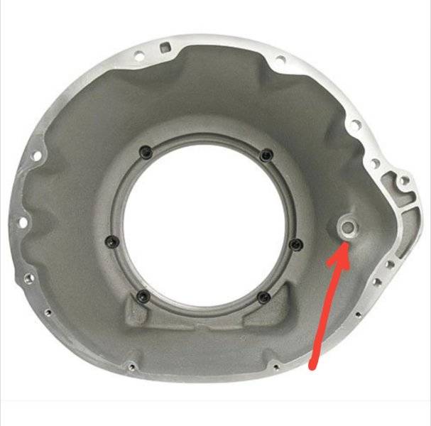

Look at the condition of the starter seat before re installing your starter too. I don't have the info on the number of teeth for ring gear/starter combos but I would double check this. You can pull all of the spark plugs before trying it next time to reduce any strain on it and listen for binding. I know on a big block, you can look up into the bell housing and see the starter bendix. Don't know about the small block. Good luck!
Not all mini starters use the nose seat pictured above. No issues with them.
Doug
Doug
Wouldn't hurt to check it for damage or deformities. Might keep the starter from seating flat on the bell housing, causing binding.

Update on the project! I did not know this but I had the stud on the wrong side and that was causing an alignment issue. They corrected it and have not had any issues since.
Sometimes it just takes a second set of eyes that knows what they are doing and small things like this can be fixed.
