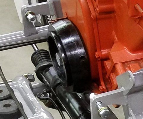

I removed a gear drive and installed a Comp Cams double roller chain. My marks are right on but now the vehicle vibrates when revving the engine and the idle rpm was at 1000 now its at 1200. It always had a slight vibration like if the harmonic balancer was going out but now it's a stronger vibration. This is a 1973 440 motor home block. It has a weighted harmonic balancer. Could the sprockets be marked wrong or cold the harmonic balancer have gotten damaged during removal? I used a puller but it was a bear. I had to soak it with PB Blaster and hit it with a mallet.

I'd say hitting on outter edge would be a problem. Start engine and look for a wobble from the side.

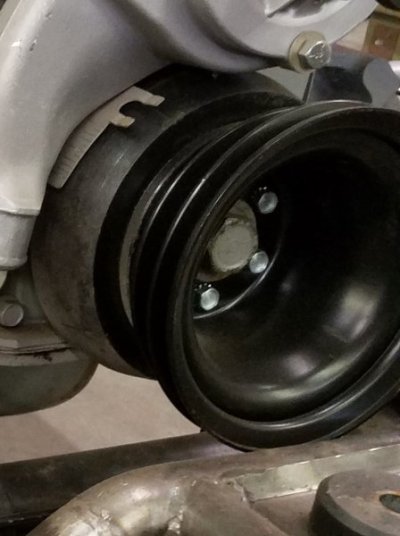

Here is the cheapo I removed.
Even if the timing was off a tooth, which it isn't according to my pictures above, that wouldn't cause vibrations through the Dash amd body right? It would cause crappy idle, power loss, and misfiring I believe.
If I get this balancer what would I need to get my belts lined up? I'm assuming since this balancer looks about an inch thinner than mine I will need some kind of pulley spacer? Or is mine just thicker on the timing cover side and the face of the balancer is in the same spot?
Never ever beat on a harmonic balancer!
They make pullers and installers for this job.
I used a puller and it started bending! I had to spray PB BLASTER and hit it while pulling then it popped free and stared to pull off.
