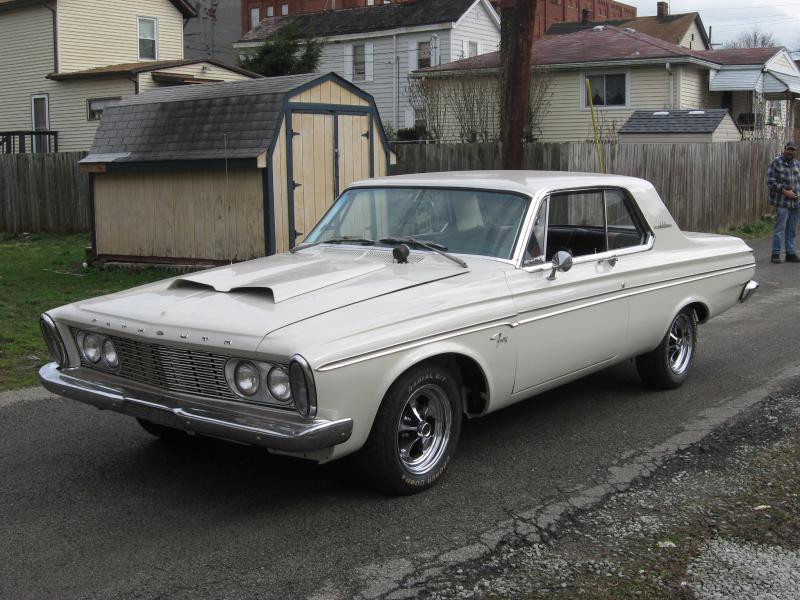

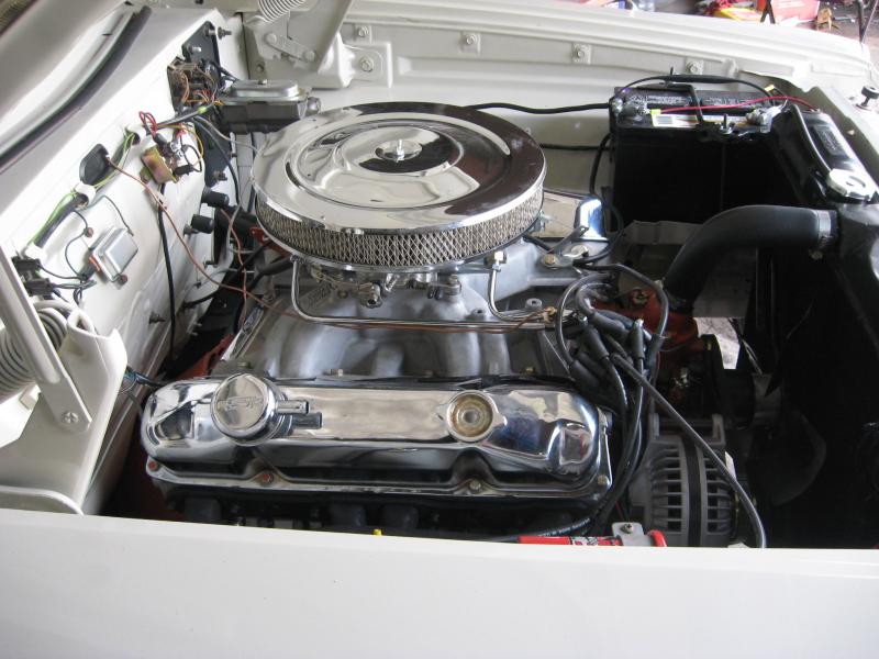

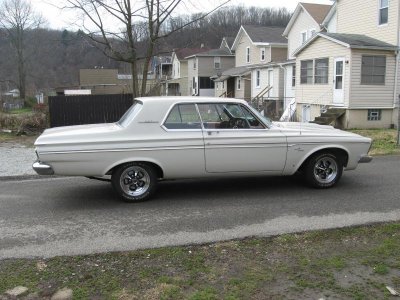

what do you guys think it will run 63 plymouth fury
.30 over 440 .005 from zero deck
ported & polished 440 source heads
comp solid flat tappet 559 lift 252 at fifty 108 center line
10.5 comp je piston
eagle rods
elde torker 2 intake 850 demon carb
4 speed stick
8 3/4 rear 410 gear
msd 6 AL
thanks Ron really like your plymouth very fast street car Bob

thanks guys its almost done 3 years to restore can't wait to run it winter is here Bob
Sure takes alot to make the Big block mopars to run..I see more impressive time with the small blocks..why is that? Not to mention other brands..Not much of a street car running around with 4k converters..I have a friend running similar weight 84 camaro,4k converter,hyd 275 dur. cam,373 gear..350 engine stock flattop motor running high elevens,cast iron heads..Why can a 500inch mopar with converter & eddy heads run the same? Is it just chevy has more technology? No I dont have a chevy.im a mopar guy..383 69roadrunner..Hate to think what a warmed over 383 will run..would think a 383 mopar could do what a 350 chevy can but havent seen that yet..
