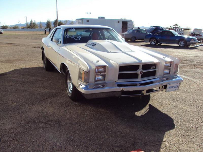

Big iron
79 300 ( Cordoba body ) Mild 408, 727, 4.56 9 1/4 diff.

Big Iron
No bad, is that 11.33 I see on the windshield ??, especially for a big iron heavy car...
11.53 was my dial that day. DA was a lousy 3500 feet above sea level.

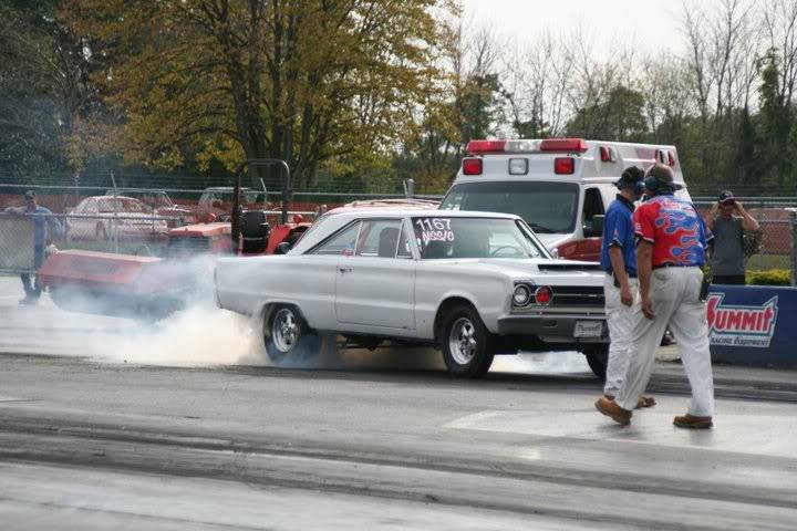

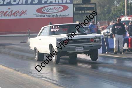

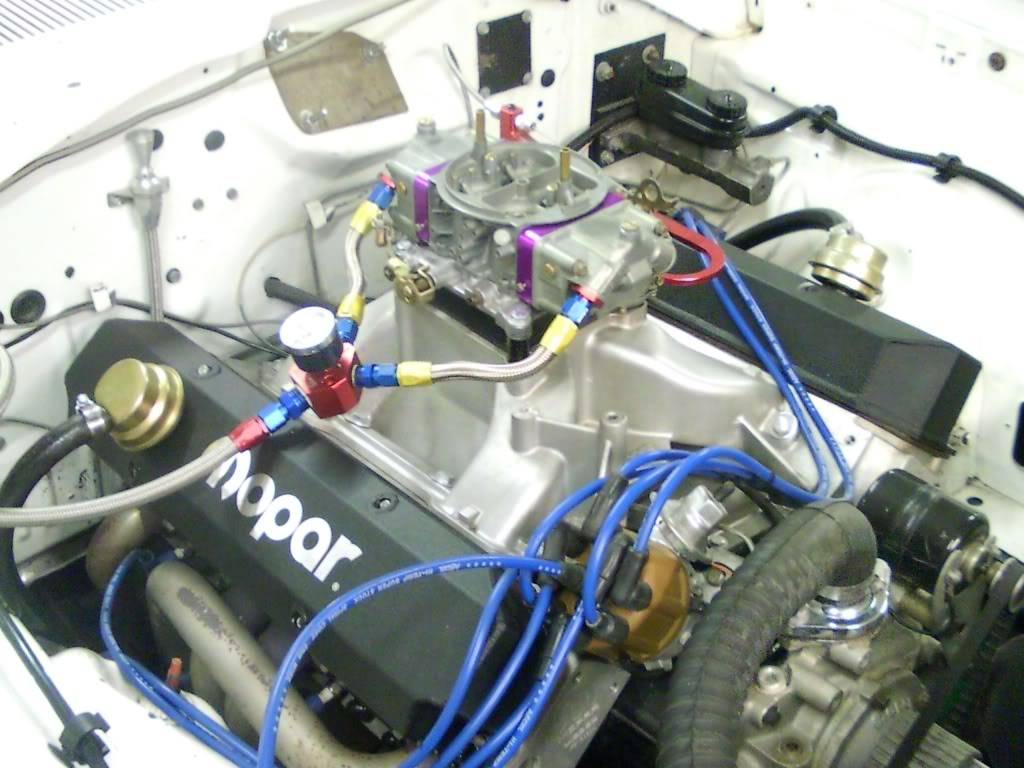

NEW UPDATED VERSION .055 over /stock stroke 440
ross dome piston (13-1)
bme alum. rods
.590 cam
MP "452" alum. head (76 cc)
max wedge ductile adj. rocker
M1 intake
750 carb (E-85)
9 inch turbo action (4500)
turbo action v/b with trans brake.(leave at 3000)
8 3/4 (then)...Dana60 (now)
4.10 (then)...4.56 (now)
29x9 (Hossiers)(then)....30x9 radials (now)
ladder bars and coil overs
stock front end
*car weighs 36xx lbs.
best et - 11.24 (then)...11.11 (now)
mph - 119 ..same
60ft. - 1.52 (then)...1.46 (now)

Sweet ride RacerAL, thanks for sharing... any more action photos ??

Al your car is looking sharp and running good ! Ron
thanks Ron..its been a long journey to get it like it is.
Great looking car, nice action shots...
